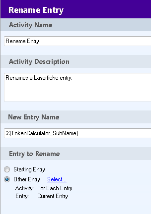

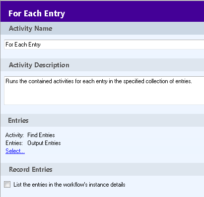

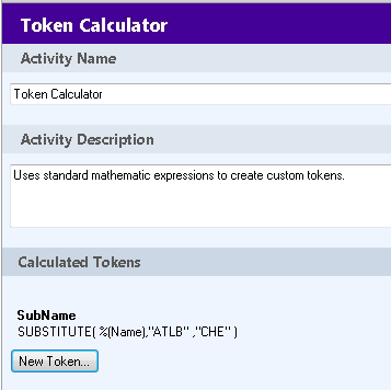

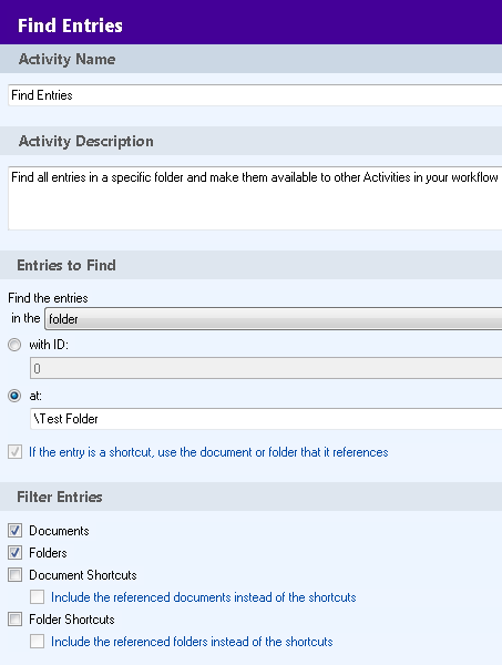

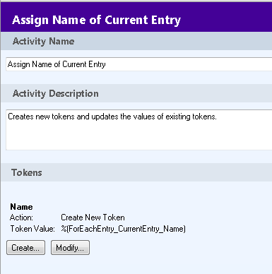

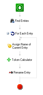

The easiest way to accomplish this is with a quick Workflow to find the entries and use the Token Calculator Substitute Function to create a token with the new name and then rename the file with it.
FYI, the Substitution Function is Case Sensitive when it looks for the characters in the string.

Once you have it tested so that you can run it against the sections of your of your repository as needed by changing the Find Entries location. Suggest you start with a test folder.
Below is a sample workflow and settings to get you through this quickly.

If you're looking at more than 500 entries to process, you'll want to put everything that's inside For Each in its own workflow and invoke it from this one. The performance will be a lot better.
Performance-wise, it would also be more efficient if you could limit your search results to a few thousands per run.
