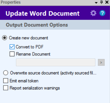

Hi Ben,
The "Update Word Document" tool in Workflow 10 allows for conversion to PDF. Click the gear icon next to the activity name and you should see the below options:
Hope this helps!

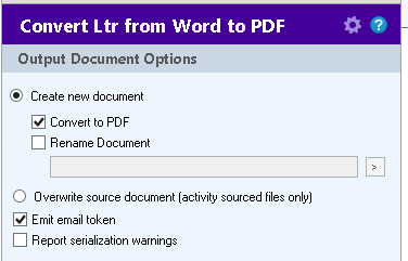

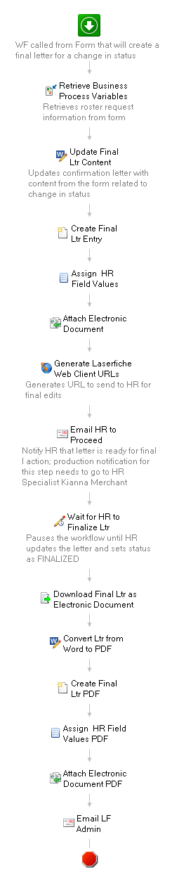

@Ben Birns, I'm using this WF activity to create a PDF to attach to an email, but now I'd like to save to the repository.  How did you save the converted PDFs back to the repository?
My WF is attached and I used the Download Electronic Document activity followed by the Create Entry, Assign Fields, and Attach Electronic document to save to the repository.  This results in a second Word document saved in the repository, not a PDF.  Thoughts?

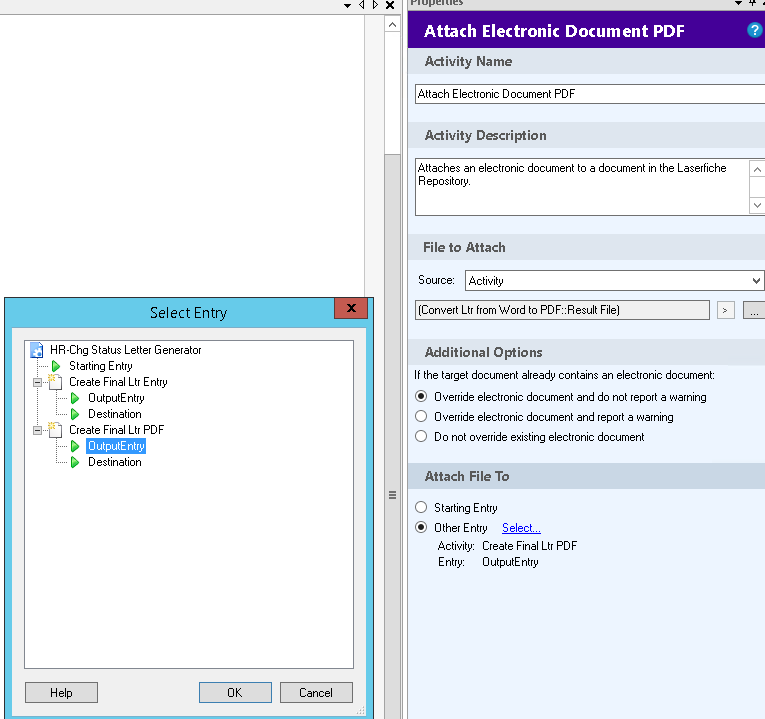

replied on April 29, 2020
Hey Michelle, in your "Attach Electronic Document PDF" activity, are you using the output from your second Update Word Activity? What do the properties on that activity look like?
Hi Anita!  Yes, I am.  See attached.
Anita, that was it.  The activity I referenced above was what I changed it to just now.  The Entry was correct, but the activity was wrong.  I made that change and I've got the PDF saved to the repository now.  Thank you!
