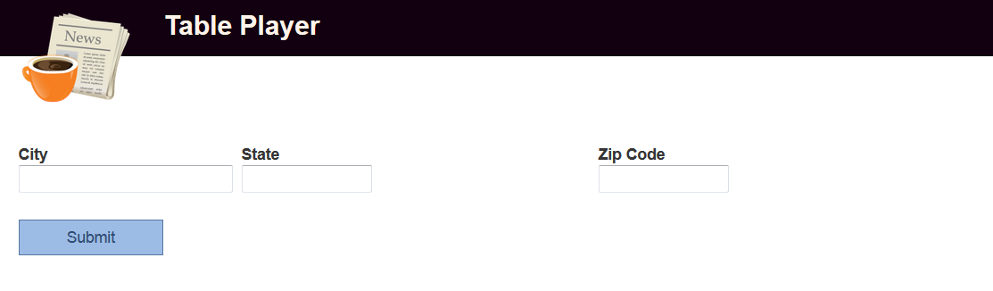

Well, you could put the labels on top...this would buy you some more room if you need all 3 fields on the same row, like this:
#q6, #q7, #q5 {display: inline-block; vertical-align:top;}
#q6 .cf-medium {width: 100%;}
#q6 .cf-field {width: 150px;}
#q7 .cf-medium {width: 100%;}
#q7 .cf-field {width: 150px;}
#q5 .cf-medium {width: 100%;}
#q5 .cf-field {width: 150px;}
Then play with the padding, but here is how it will look at 900 on the form size:

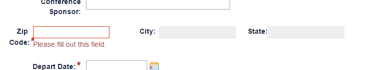

This is the CSS I always use so that i can adjust the label and field sizes precisely by the number of pixels per item.  You would simply adjust the pixel value per item to make the field or label wider or shorter.
#q1 label {width: 170px;}
#q1 .cf-small {width: 150px;}
#q1 .cf-field {width: 150px;}
#q2 label {width: 120px;}
#q2 .cf-small {width: 180px;}
#q2 .cf-field {width: 180px;}
#q1, #q2 {display: inline-block;

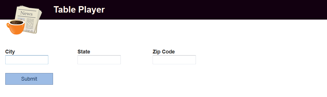

I got it to display like this now. Would I just adjust the width fields to get it to align how I want or is there another type of code that needs to be inserted to align them?
replied on September 26, 2016
Jorge,
You can add some lines to affect each group of fields, for example in the following picture I have added a line to set the width between the first field and the second field, and then another line to give more space between the second field and the third field:
#q6, #q7{width: 180px;}
#q7, #q5{width: 300px;}
