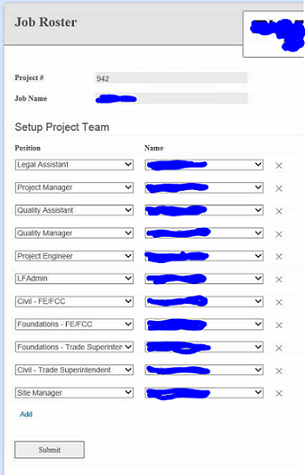

Roster form completed:

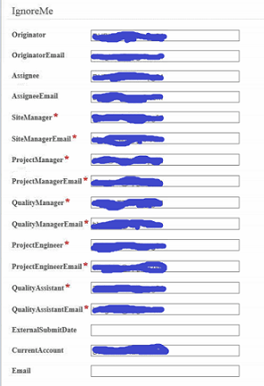

Report form completed:

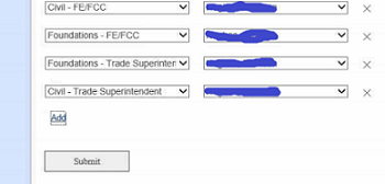

Roster form updated: (Site Manager removed)
The workflow kicks off and it updates the “roster” SQL table.  Now, if you open the user task, I can see the JavaScript functions happening (because of show/hides, alerts, etc.), but the look-up does not refresh to match the updated SQL table, meaning it still populates with the original data the form was submitted with.

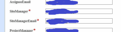

Report with original data still (look-up did not refresh - Site Mgr still populated, should be empty):
