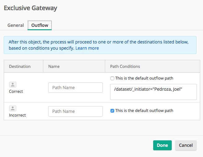

I am having trouble with forms routing correctly when I try to use an exclusive gateway and I set the path condition to use /dataset/_initiator="Pedroza, Joel"
Any idea on why this is not working?

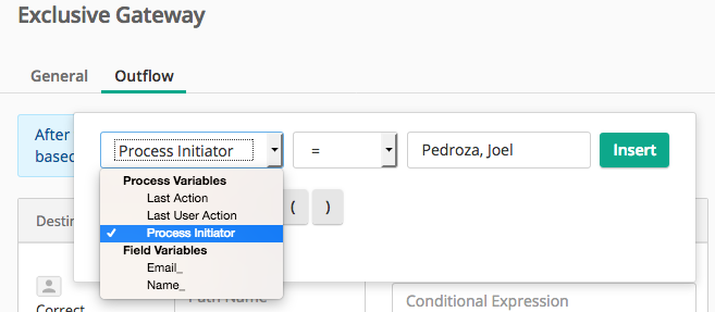

Hi Blake,
Thank you for your response. Process initiator shows up as an option on the drop down for me, and I type in the name exactly as it shows up in my account. I'm attaching a screen shot of the menu.

replied on September 21, 2016
Sorry about that, I found it as well now. I would guess that the name is not matching the value for the Process Initiator. It may be using something else than the name for that value.

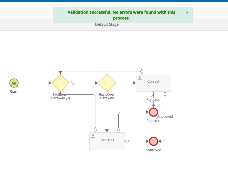

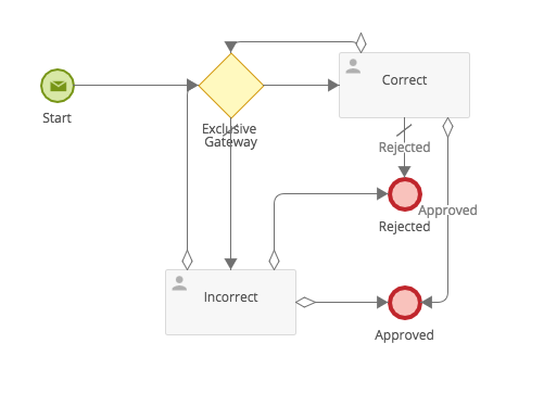

I think your problem maybe that you have multiple incoming and outgoing sequence flows into and out of your gateway.   Run the 'validate' option next to the save button.
The gateway named "Exclusive Gateway" in the "Main Process" is improperly connected to other objects. Gateways cannot have multiple incoming and outgoing sequence flows.
Hi Andrew,
Yes you are correct that was a problem, I made a mistake while trying to create this to replicate the problem.  I corrected it but the problem still persists with the routing.
