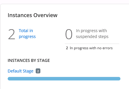

Hi Miruna,
Below is what is showing on the Operational Dashboard:
If I open the instance that the Workflow Terminated on:
Below is the Workflow:
Is this not the default behaviour?
Thanks
