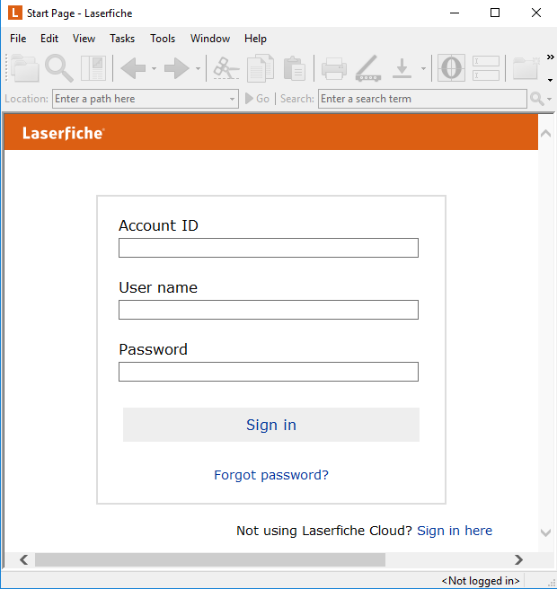

Thanks for the reply.  How do we go about pulling the Repository name?  When you look at the login screen in the 10 client, it just asks for the account id, user name, and password.

I know and understand how to get the information manually, but I was trying to grab it programmatically and stay consistent with how it appears in the client.
It never asks for the Host name, but still logs into the correct repository.  I do not want to make the user have to provide a host name if I don't have to.

We're trying to get cloud server/repository using Account ID/User Name/Password, the same as how end user logs into Cloud from client.
User won't know how to get "r-xxxxxxxx.laserfiche.com" value without further instruction.
