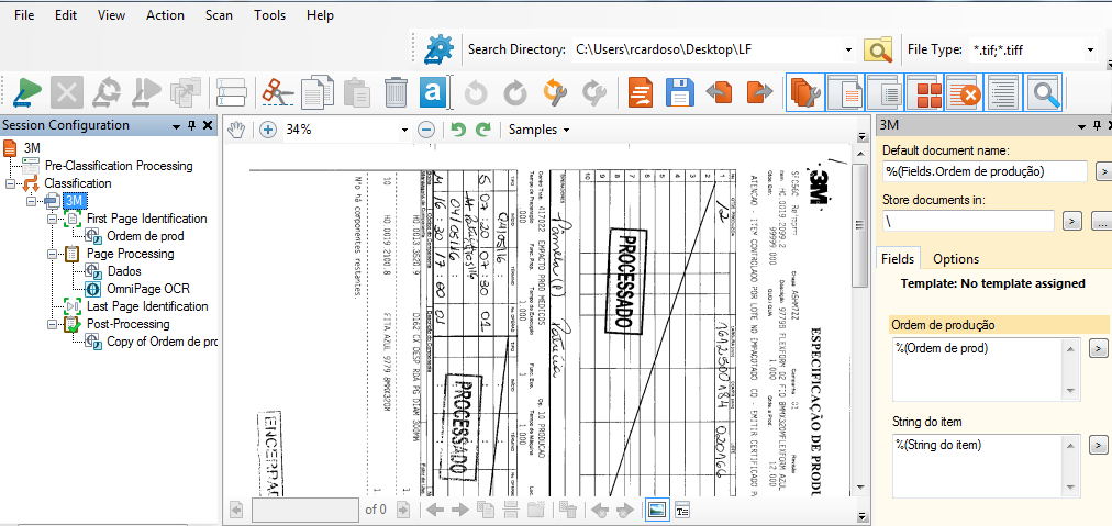

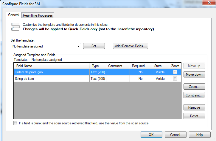

Attached , I am sending prints of how it is configured the quick fields , see if it is correct please and I'm using all the improvements I know.

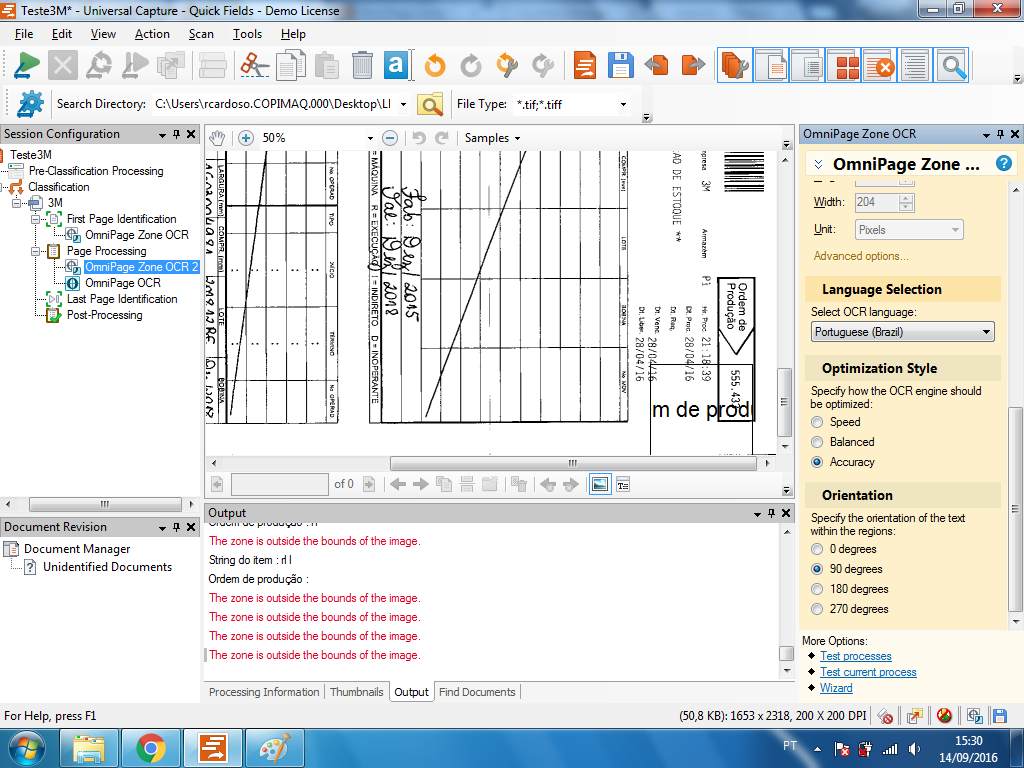

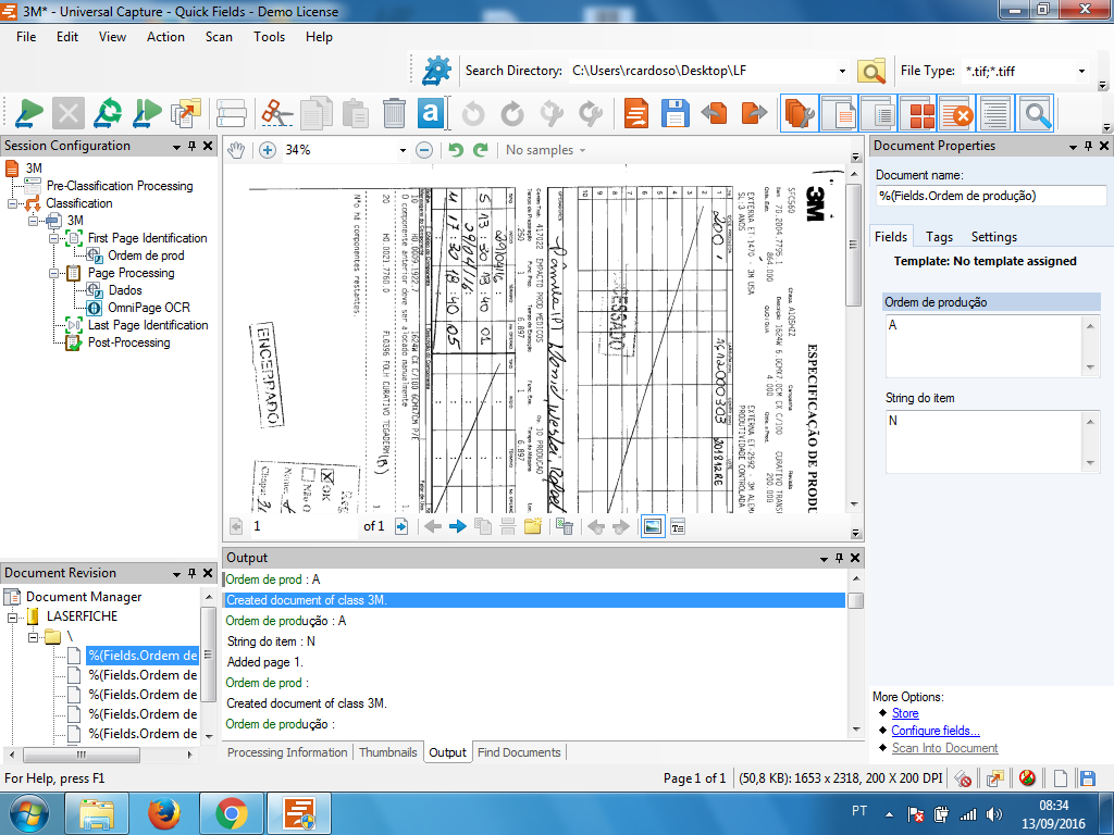

Hello, Here is a print of how it looks later .
replied on September 13, 2016
Okay, so now I can see that it's capturing something with your Zone OCR process but it's not capturing the right thing.
Is your zone configured in the correct location and is it set to capture the text in the correct orientation? (since your page is sideways)
