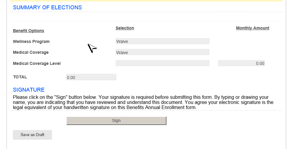

I have a form that looks this way before submitting (note the hidden monthly amounts, right aligned monthly amounts and only 3 benefit options rows).
I am using css to control the formatting of the monthly amount (heading and field).

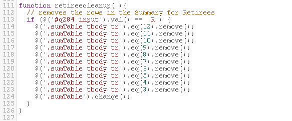

I am using jquery to remove the unnecessary benefit options rows.

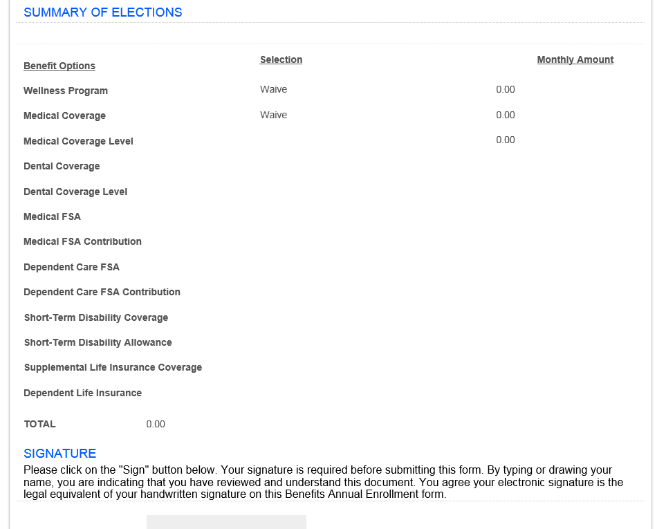

Once it is submitted, the screen for this section looks like this:
How do I get the "end result" form to look the same as the "in-progress" form?

The elements such as input/textarea on submitted form will be converted to div, you can change the condition to  "if (($('#q284 input').val()=='R')||($('#q284 div').val()=='R'))" to make it work on submitted form.

The problem was not with #q284, but with the .sumTable -- it is a fixed number of rows table that I was trying to use as a dual table -- for active and retirees.  The retirees only need 3 rows as oppose to the original 13.  In the end, I made a duplicate table and manually deleted the extra rows.  But the div information is valuable elsewhere.
