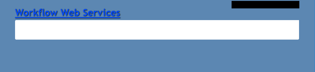

Next, from the workstation where the Laserfiche Client is installed, open a web browser and confirm that going to http://servername/Workflow takes you to a page that looks like
Once that's been done, please try starting the business process from the Client again.

Hi Alex, we are having a very similar issue. We are able to browse to the URL just fine via IE. But the WF Web Services > Web Application Directory path fails when we click on the Test link. As a result, the business processes fail to work correctly.
