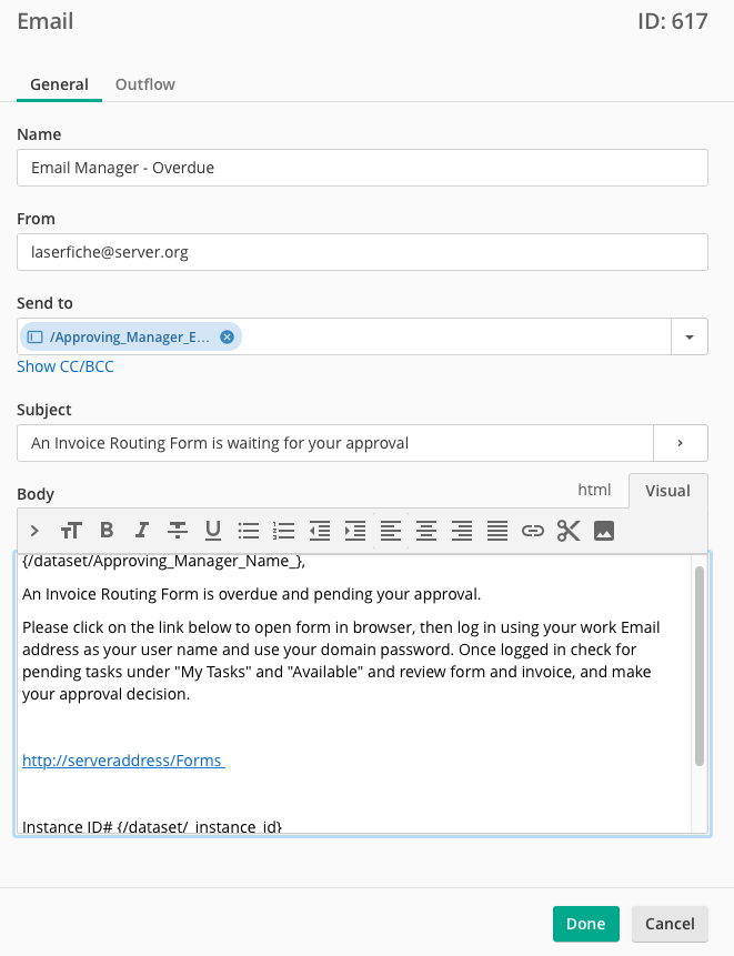

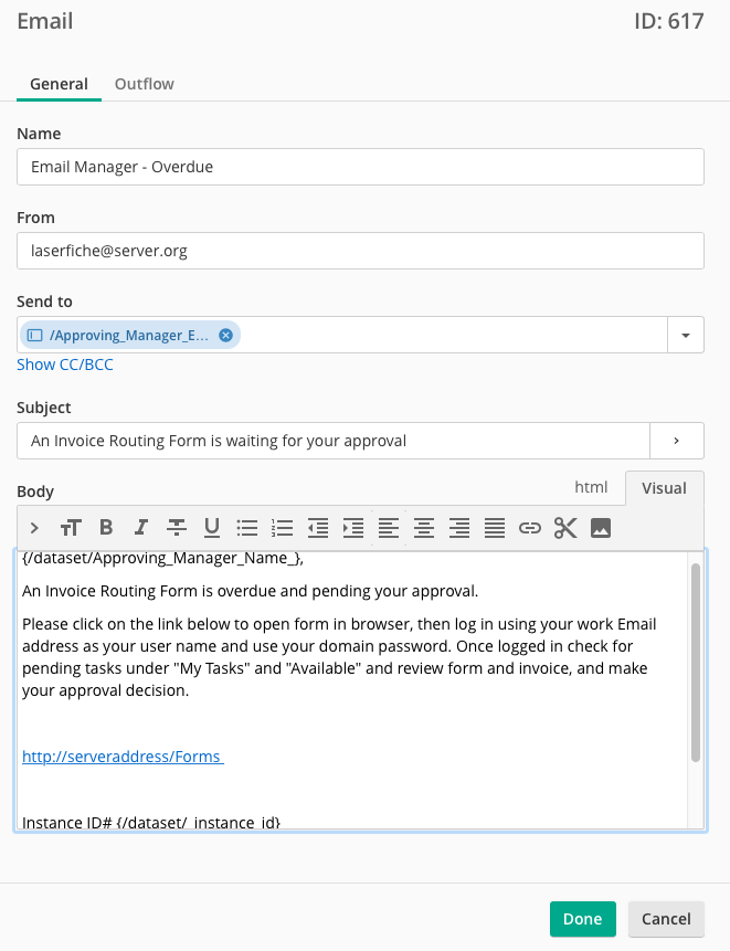

replied on March 16, 2018
Yes that works fine if you do an email service task after a non-interrupt timer.
