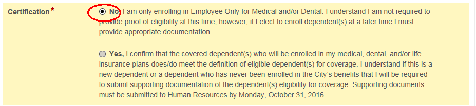

The problem is that the text values and radio button values are not showing correctly.  Here is the form filled out:
But this is what is presented like after the submit button is clicked:

The radio field is required, but I am changing whether an option is disabled with jquery.
      document.getElementById('Field151-0').disabled = false;
      document.getElementById('Field151-1').disabled = true;
replied on August 24, 2016
Set the radio button with disabled attribute will make the value not be submitted.(http://www.w3schools.com/tags/att_input_disabled.asp). And radio button element has no readonly attribute. You can change your script to set the radio button option to be enabled when it is selected to avoid this issue.
