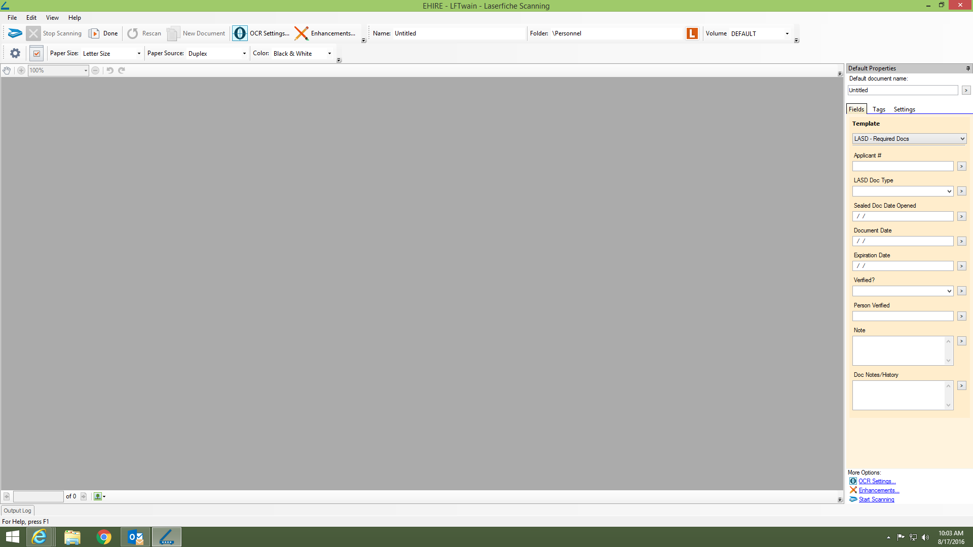

Is there a way to make the WebAccess WebScan utility match the clients scan tool?  The thumbnail pane and the "Revisions/Scanned Documents" pane are needed for page rearranging, multi scan handling, and document split/merge.  At least in any way more intuitive then I can find.  Any suggestions would be greatly appreciated.

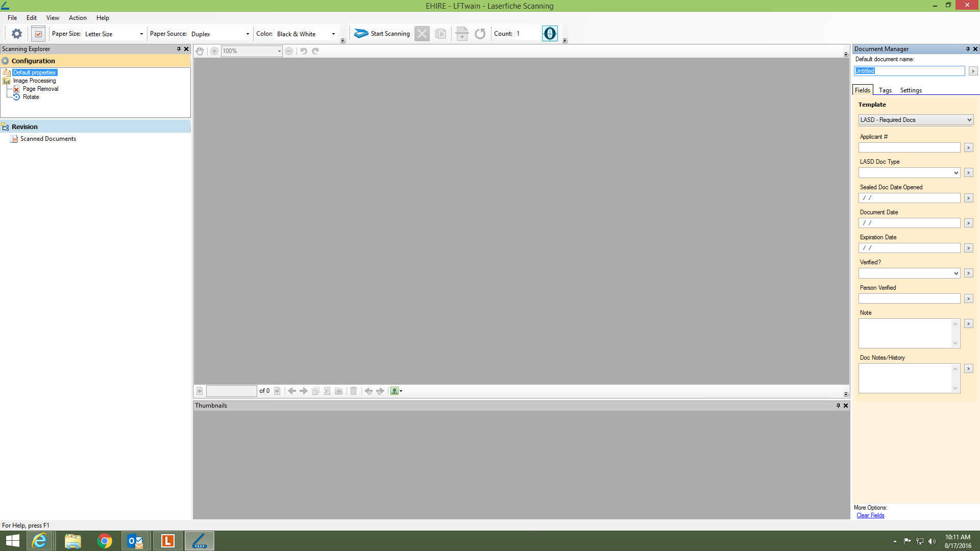

replied on August 17, 2016
Below is a screen capture of the WebAccess Scan utility.  It is entirely possible, that it is opening in Basic mode, It does not seem to offer an option like the client does.  Is there a place where I can change the settings? I've attempted to search all of the options.
In the sample below, you will notice the missing sections.
WEBACCESS OPENED SCANNER
Client Opened
That is definitely Basic mode. You most likely checked the "do not show again" box on the scanning mode selection dialog. You can turn it off from the Options page in Web Access under Reset\Confirmation by resetting all hidden prompts.
That fixed it.  Thank you very much.
