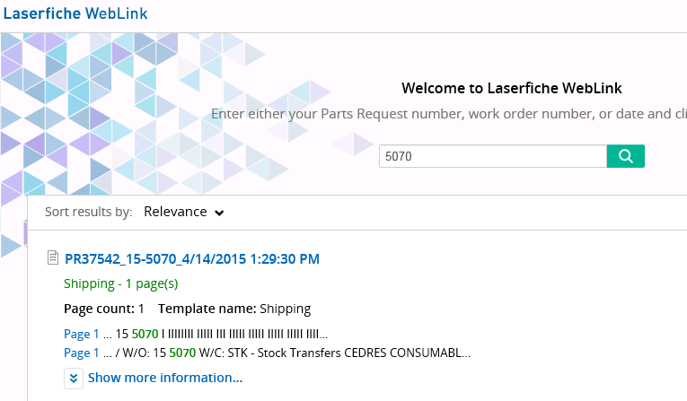

How do I get the sort result default to the "Date modified", when doing a quick weblink search from the welcome page
asked on August 16, 2016 • Show version history
I have test some change in the welcome.apx file to add feature as explain in different post about changing the default.
but did not work with the weblink version 9
to default

OK got it, in my situation the search was done on the welcome page, so the file I should modified was the welcome.aspx.vb at line 61 (second line in the following code)
 MySearchResultsBrowser.Columns = WebLinkControls.ColumnSelect8.GetSelectedColumns(Page, m_Conn, "SearchColumns", Nothing)
            MySearchResultsBrowser.DefaultSortColumn = Column_Type.COLUMN_TYPE_LASTDATE
            MySearchResultsBrowser.Visible = False ' SCR 124092
And I build back the weblink project, restart IIS and now it works
