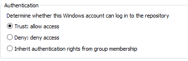

I have created a group on Exchange 2013 [abcd] and added the group into LF Administration Console Windows account as below
Authenticated is being selected as below

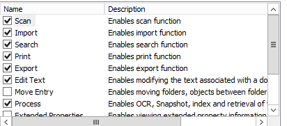

and rights given as below:
However, the users in the group are unable to access a folder created with access rights given from the group.

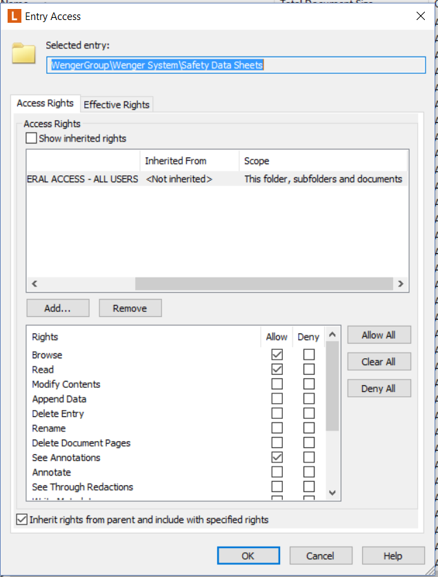

Iqbal, when you went into the Laserfiche Client and assigned the group to the folder, did you check the scope of the group?  Meaning, was the scope limited to 'this folder only' which would preclude access to any of the folders below it?
replied on August 16, 2016
Hello Michelle,
below is the screenshot
i'm getting <not inherited> when selecting the"show inherited rights"
Is there a way to make it inherited to the"ITL-Live" ?
thanks in advance
replied on August 17, 2016 Show version history
Iqbal when you see the <not inherited> it means that you set that group specifically on that folder (i.e. folder B) and that they do not inherit rights from the folder above (i.e. folder A).
If you want the groups to inherit rights down to folder B, you need to apply the groups to folder A with the appropriate access rights and make sure that "Inherit rights from parent and include with specified rights" is checked on folder B.  (Which it looks like it is if you see the ITL-Live inheritance for your ADMIN.)
But the scope of the access must still be configured.  If you want the groups to have access to folder A and all its subfolders and documents so that this inherits down to folder B you need to set the scope to "This folder, subfolders, and documents."
Hope this helps.
Hello Michelle,
As you can see below, it is not inherited from the parent group, however, the users in this group are still unable to see the folder.
though i have given them full rights on the child folder.
Any idea why is not working
