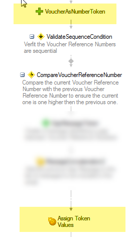

Here is a part of the workflow...

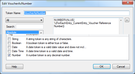

The Voucher Reference Number is a string so the first thing I do is convert it to a number.  The first activity looks like this...
Notice I am defining the token as a Number.

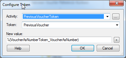

The last activity in the list is assigning the converted Voucher Reference Number to another token so it can be used in the next iteration.
Here is that activity...
The condition is comparing the converted Voucher Reference Number to the previous Voucher Reference Number to make sure it is one higher.

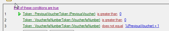

The example below shows the previous Voucher Reference Number is 49983 and the current Voucher Reference Number is 549050.  I would expect the condition to be true but it is not...
Here is the activity condition...
And here is what it looks like when it is run...
What am I doing wrong?

Condition evaluation does not do calculations. So it is literally expecting the value to be "49983 + 1". You have to calculate it first with a Token Calculator activity and use the new value in the condition.
replied on August 5, 2016 Show version history
If that is the case then the condition should be true for every iteration.  Why does it evaluate to false since they are clearly not equal
We have been burned by this before. Miruna's suggestion should work, but the behavior is pretty darn confusing for the reason you mentioned.
