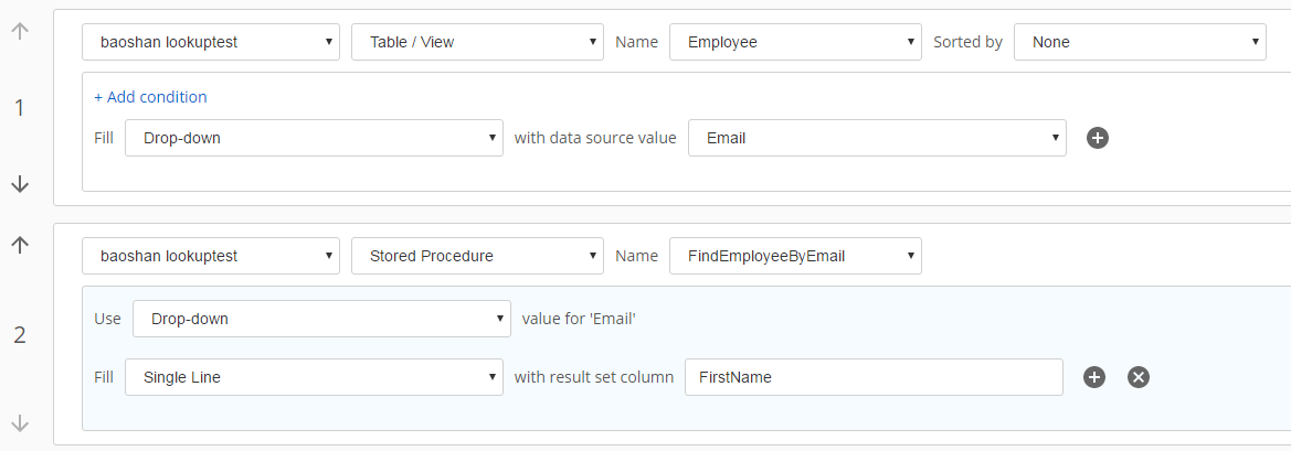

No custom JavaScript is needed for the function to work. Here is the lookup rule settings I used (use one table and one stored procedure):
And you mentioned that you're using the same stored procedure to populate both the drop down and the target field. If the stored procedure has an input, how do you use it to populate the drop down field? Can you post your lookup rules here?

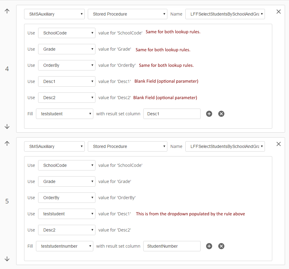

The screen shot you posted is in essence the way I have it setup.  I just have a few more parameters.
The second rule basically uses the input from the first rule to lookup an additional piece of information for the same record.  This is necessary because Laserfiche Forms for some unknown reason refuses to support assigning values to choices for a drop down populated via a lookup.  I've posted about this previously here but haven't received any info or figured out a better work around.

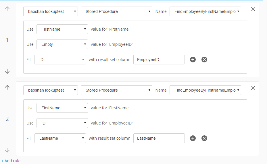

I built a similar form and the lookup rules worked for me (ID is the dropdown field, and value can be filled into the LastName field when click auto fill.)
Have you tried other tables/stored procedures with auto fill buttons on this form? Did that work?
If it worked, then the issue may be with your stored procedure. Can you try executing the stored procedure with the same input in sql management studio?
