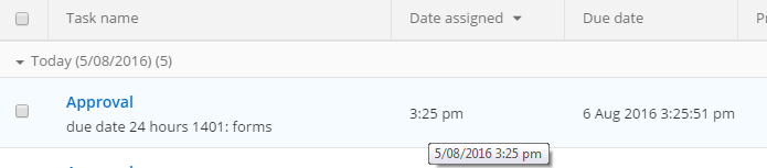

I tried changing server region and browser display language to English(Australia), and changing routing service configure date/time format to "dd/MM/yyyy", but I can't reproduce the issue. The due date is correct:
Is there any other setting you've made?
