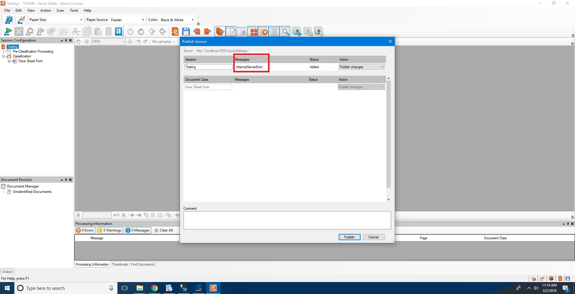

replied on March 1, 2018 Show version history
Hi,
I am trying to publish a QF session but i am getting Internal Server error:

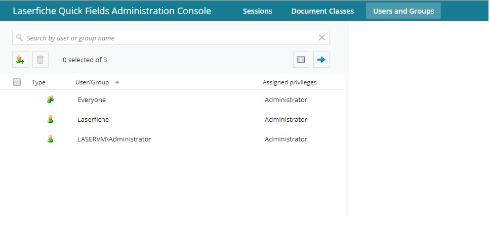

Also, I have checked the Users and Groups in Admin console and all users have full rights:
