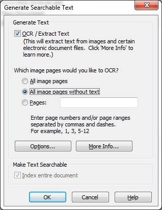

Yes, just run a search for all your documents in the Client, select all, and Generate Searchable Text on them.

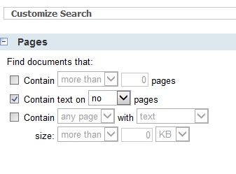

You may wish to do your search for documents that contain text on no pages:
Then maybe run the search again for those that have text on "some" pages.  When you do your OCR I would have the "All image pages without text" option selected so that it will only do missed pages and not re-do everything.
