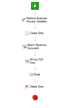

I have a public portal Form taking information in from our client's employees.  This I need to push into an encrypted PDF that is emailed to their relevant supervisor, who then can review and fill out a different Form that's tied back to the original with a unique ID.

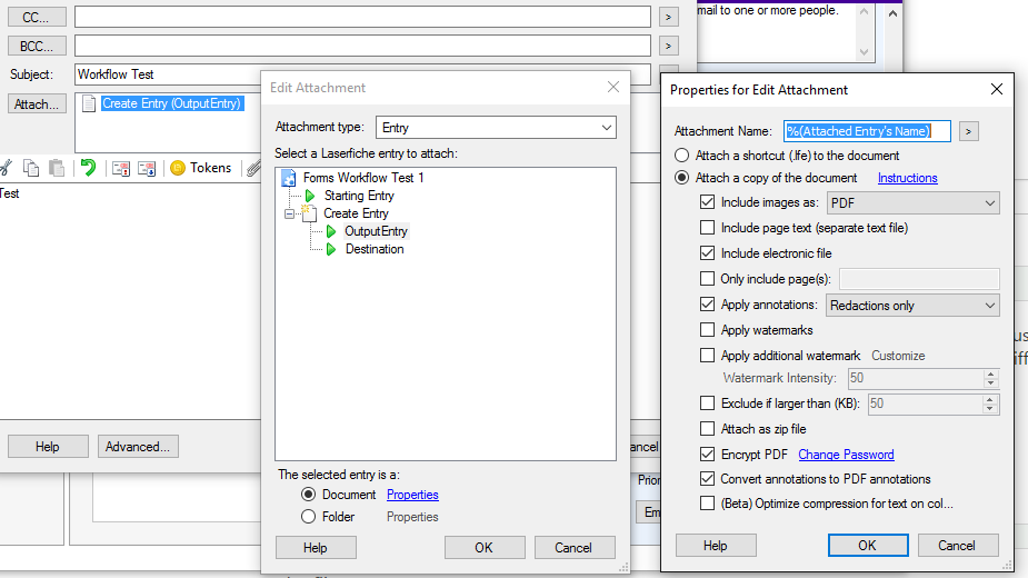

The proof of concept workflow works EXCEPT that there's no encryption when it arrives.  My guess is that it needs to be an LF image file that is created during attachment to add encryption on?  If so, what's the best way to step a filled PDF through that path?  Alternatively, any SDK workarounds?

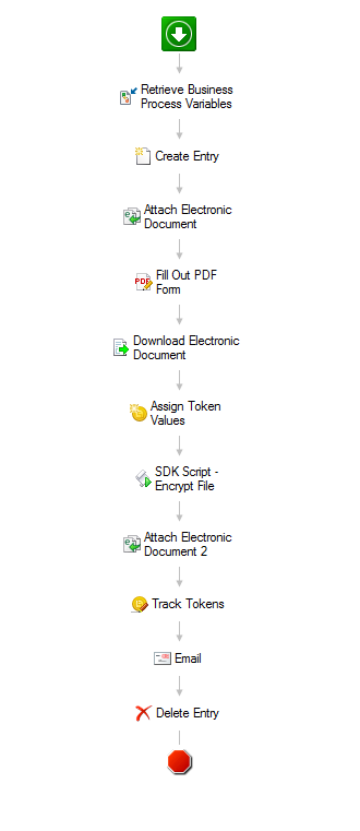

In case anyone needs a solution on this, at least until Laserfiche adds an option to encrypt and email the filled PDF itself, I ended up having to export the file to the local server, use a script to pass a .bat file that file location and password (which then calls the .exe file to encrypt the PDF, which was a workaround for the System32 folder's library restrictions), grab the returned encrypted file's location through the .bat, replace the electronic document with the newly encrypted one, and then send that off with the email as an attachment.  A lot of steps to get it done, but it does.
What it looks like in Workflow:
The script (VB):

Yes, the option applies to image pages exported as PDF.
