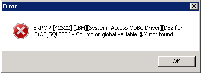

I'm trying to see what would be different in the Workflow Custom Query activity when declaring Variables to use in a Query against a DB2 database. If I test my query using no Variables and type each value, I get the expected result but when I try and make use of a Variable, then I get the below error:

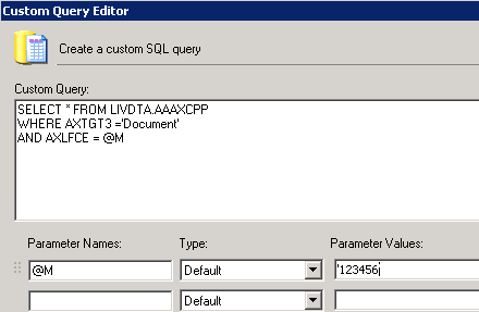

Query using a Replacement value for one of the fields:
SELECT * FROM LIVDTA.AAAXCPP
WHERE AXTGT3 ='Document'
AND AXLFCE = @M
Screenshot of Query config in WF:
Note that I tried with putting '' around the values under "Parameter Values" and without
Screenshot of the error:
If I put '' around the Variable in the query ie '@M' then the query runs but does not return a result which it is supposed to.

Based on the screenshot, it looks like you're using an ODBC driver for DB2? ODBC drivers don't allow for naming parameters. They have to all be "?" and their values are used based on the order they're specified.

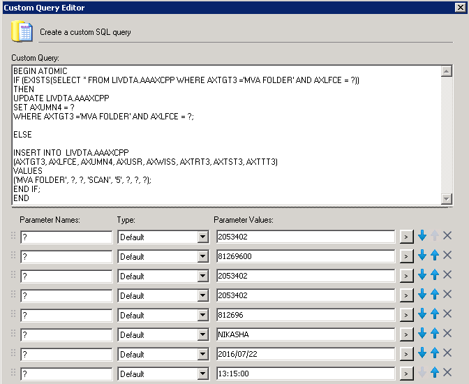

I think I figured out what you explained and got it to work in the initial Sample sent above. If one has to provide them in the order of how they are used, how does this effect Nested queries using the same variable in multiple places in the query?
Consider the following query:
BEGIN ATOMIC
IF (EXISTS(SELECT * FROM LIVDTA.AAAXCPP WHERE AXTGT3 ='MVA FOLDER' AND AXLFCE = @Mva))
THEN
UPDATE LIVDTA.AAAXCPP
SET AXUMN4 = @FolderID
WHERE AXTGT3 ='MVA FOLDER' AND AXLFCE = @Mva;
ELSE
INSERT INTO  LIVDTA.AAAXCPP
(AXTGT3, AXLFCE, AXUMN4, AXUSR, AXWISS, AXTRT3, AXTST3, AXTTT3)
VALUES
('MVA FOLDER', @Mva, @FolderID, 'SCAN', '5', @User, @Date, @Time);
END IF;
END
Does it mean that in the above query, I would replace all the "@name" variables with "?" and then for a variable like "@Mva" I would in the Parameter Configuration have 3 separate "?" lines being stipulated?
So for this query I would have a total of 8 "?" Parameter lines configured?

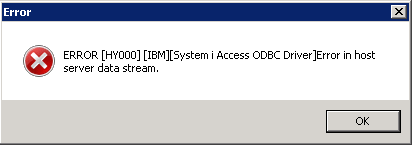

Miruna, based on my understanding of what you explained I did the following change and tested it with the full query:
However, this did not work and gave the following error:
If I go back to just a normal Select query with only one variable that is referenced by a "?" then it works and a result is returned.
replied on July 22, 2016
As far as the other error you're getting, it's a driver error, so it's not something we can troubleshoot. Quick Google  search seems to indicate a possible bug in the driver, but you'd probably get a better answer on IBM's forums.
