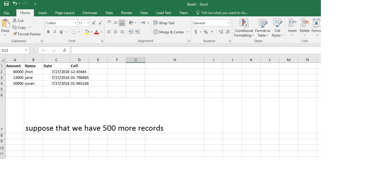

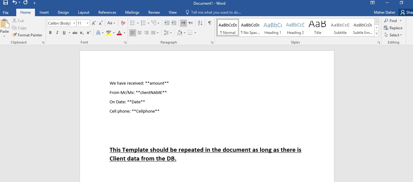

we want to extract from the DB all the data and update the word document from a template which is not in form of a table as shown in the template.jpg and the data from excel as shown in excel.jpg .
is it possible to dynamically fill the document using the "Update word document" activity from workflow using this template ?

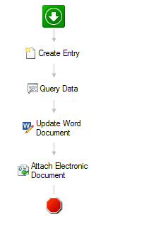

Yes, that looks like a scenario that is expected to work. But, I'm sorry, there isn't enough information to troubleshoot. Your screenshots don't show the merge field definitions, or the workflow. If you think you have those set up correctly but Workflow does not work as expected, I would recommend opening up a support case.

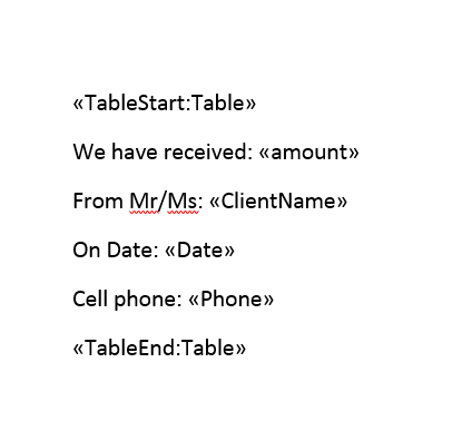

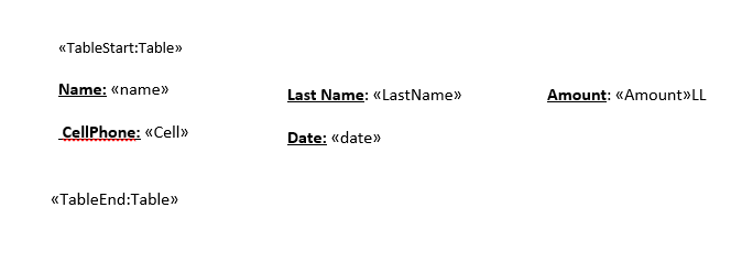

i followed your advice from this post (https://answers.laserfiche.com/questions/90221/Update-Word-Document#98869)
and i realized that i don't get the desired Format that would look like this

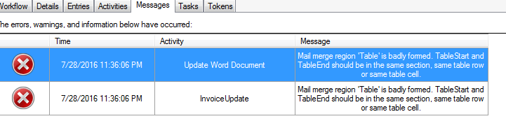

and by using the method u talked about i get this error from workflow:

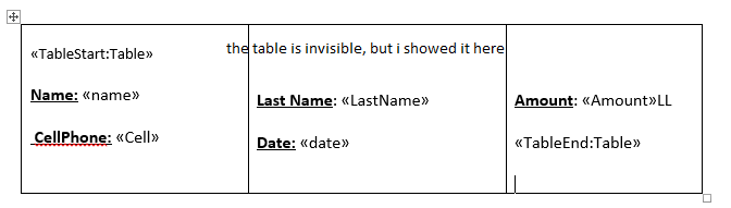

but i made it work using an invisible table (no borders) where in it i put the merge fields .as follows:
My question is :  is there any other way that my workflow can do this without going into all these turn arounds and get the same results ? and the same format and dynamically fill update the word document from the dataBase ?

replied on August 1, 2016
Like I said above, you don't have to use a table. But if you are going to use a table, then you can't put multiple columns in the same cell.
