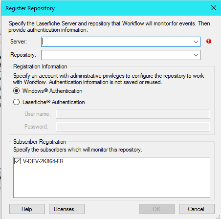

We're talking about this dialog, right?
Yes, the user matters. It needs to be a Laserfiche user (not a service account) with the Manage Trustees privilege as it is configuring the built-in WFuser$ account that will be used by the WF Subscriber. So, "admin" or a similar account.

Correct. I think we did try the admin credentials at one point, but still didn't get it to work. I've now re-confirmed that. I removed the reference, and re-added it using the Admin credentials.
