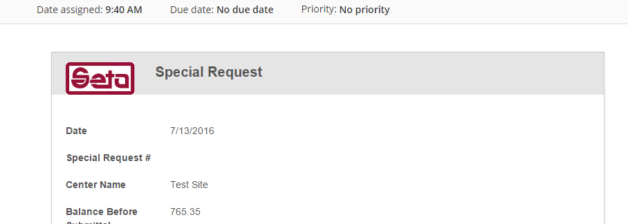

The was my initial thought as well.  Use the field with the instance ID on the last form at least for storage purposes in Laserfiche.  But the field is still blank upon storing to Laserfiche.  The metadata field for that same value on the other hand is working just fine.
This is not the submitted form for the approval process.
Value in Special Request # is:   {/dataset/_instance_id}

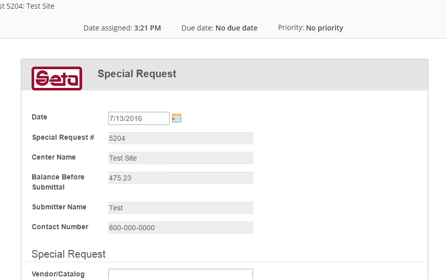

replied on July 13, 2016
Never mind.  Interestingly enough when I assigned the approval to me it then filled the value as it should.
replied on July 13, 2016 Show version history
That makes sense. The initial submission would have the "original" value from the submission time. When the form gets to your user task, the process has started, so there's a submission ID to be populated in the field.
I'm not seeing that behavior, the user task using the same form still shows the field as blank.
I have it as read-only and I am the approver and I can see it.  The form used it not the form used on submission, I have an Approver Form in the process.  It's visible for me.
Yeah, ok, the separate form explains it then. That would be populated after the process starts.
