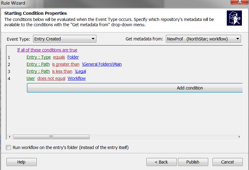

If the folder is in a specific directory or group of folders, you could have that BE the initiating condition for the workflow.  In other words, if you are running a workflow to check if a folder was created in a certain directory, maybe even with a certain name, it would run every hour to check.  BUT...if you made the workflow condition to be enacted when a new folder is created in a specific directory or subfolder group, by using the greater than or less than folder path, it would never run UNLESS that new folder was created.  Something like this:

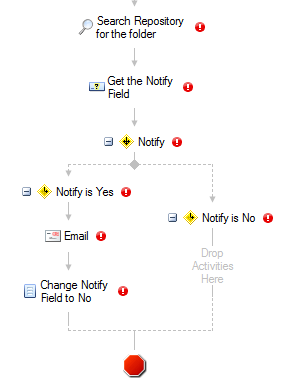

No, that is about right.  It depends if the folder in question is created by a workflow too.  If the folder is created via a workflow then you can put your notification in that workflow and be done.
However, if the folder is just created by a person at some point during the day, then you would need just a simple check workflow.  Does the folder have metadata?  You could put a 'notify' field on the template or as a separate field or something.  Then when you find the folder, check to see if the Notify is Yes or No.  If Yes, get the email and then switch the Notify to No.  If No, do nothing.
Not sure if that is fits or not.  You could also tag it with an info tag when you find it the first time.  Then your routing decision becomes a tag check or not.

Then it would run and email you....otherwise it would never run.  That way if you don't get the email, you know it wasn't created.  You could also specify a name as the "Entry Name = " and then have everyone follow the naming convention so you wouldn't have to worry about other folders being created in that path and kicking off the workflow as well.
replied on July 12, 2016
I think that might work - hadn't thought of doing it that way.  Have the workflow kick in whenever a new folder is created in that directory.  (And actually tagging the located folder would probably work too, that would be one way to flag it as well.)

Yep, that worked - I have the workflow now running only when a new folder is created, so it now only runs when the condition is met, not on an hourly schedule.
