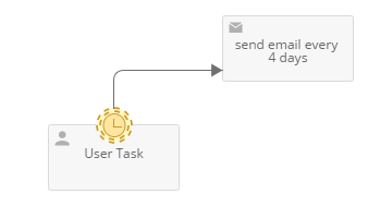

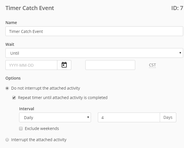

With Forms 10.1, you can attach a timer to the user task and set the timer to "repeat timer until attached activity is completed" and connect the timer to an email service task to send notification every 4 days:

One thing to keep in mind is that by doing it the way Xuhong suggests does not send a link to complete the task in the email.

You can just connect the email service task to an end event. In the email, you can ask them to open the Inbox page to check their assigned tasks as there is not direct task link can be sent out in the email service task.

In the Process Modeler you can right click on the user task and then select Attach Timer Event. From there you can set the intervals. If you would like the task to stay at that task, make sure to set the timer event to Interrupt the Attached Activity. You will also need to use the arrows and connect the timer back to the user task. So it will look like the following:
replied on January 26, 2017
This does work, though I usually set mine to not interrupt the attached activity.  The reason is that when it 'interrupts' the task, multiple tasks with the same task name start accumulating in the assignee's task list on the Forms site.  This confuses them.  Since it is interrupted it still shows the task with the old date assigned, as well as assigning the 'new' task with the same name but a newer date.
