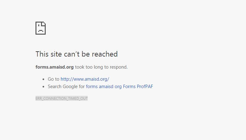

Hello,
One of their forms is sending a link to another form and the notes variable is in the link. When there is a carriage return, it is processed as a <br>. When the <br> is in a web address, it can’t process it and it will error when the user clicks on the link. If the users take out the <br> in the address line the form loads. This of course is not a solution. They have tried a fix that previously worked in version 9, that being, (wrapping the notes variable in a <pre>) but this does not work. When users click on the link in the email, it brings them to a page ( Screen shot attached). The user states that there are no errors or warnings on the server. They believe it to be an HTML issue.
Thanks!
