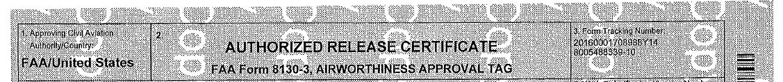

Hello,
I have a lot of documents to process in quickfield. Every documents have the same type and the same issue (cf attachments). I need to delete the background on each file, I thought there was a Quick Field activity named "background removal" but I can't find it anymore.
I have already tried to use invert color, despeckle, color removal (doesn't work on black and white documents) and some other activities but I get to much garbage values.
For those who would like to try my goal is to get the first line right under the "Form tracking number" line. I get some good results on few documents but most of them give me wrong values.
Any idea ?

replied on July 5, 2016
Hmm, I agree, these documents are tricky. Do you have access to the originals? If that background was originally in color and you are able to re-scan them in color, then you should be able to use 'color smoothing' to get much better results.
