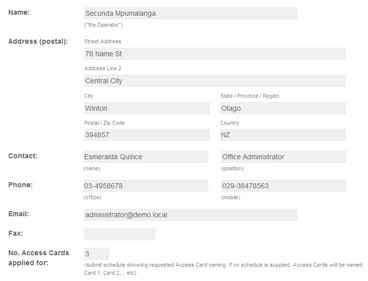

I am assuming that due to formatting the label width CSS to 5px to get the fields to line up with the preceding address fields, when I convert the form to read-only for the subsequent review process the text under the right-hand fields displays vertically.  I created a copy of the form, made the fields read-only and that resolved the issue for the review process:
However when the PDF is created in the repository it reverts to the vertical layout despite ensuring that the form being stored is the one processed for review:

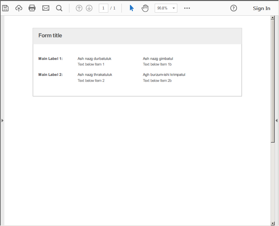

Hi Mike, I did some playing with this. It looks like the "Text Above"/"Text Below" are actually HTML label elements, so they are also affected by your CSS rule. If you change your CSS rule to have the selector "#q12 .cf-label" then your immediate issue might be resolved.

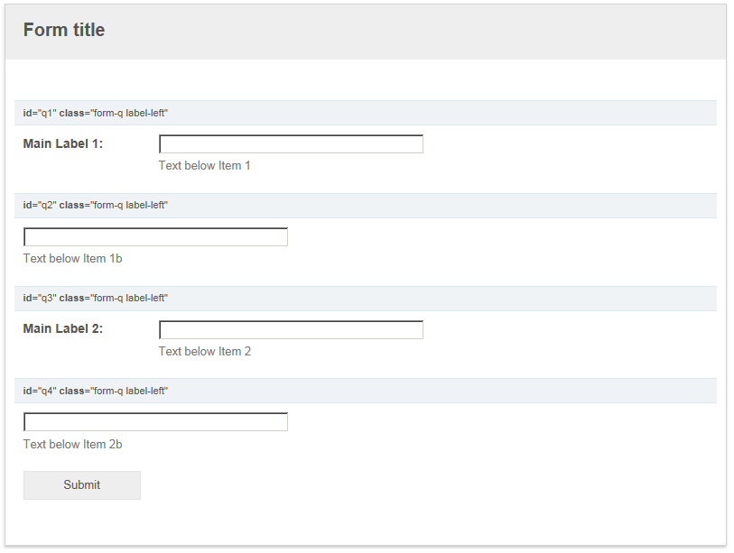

Here's another way to approach the CSS for the form. In this example I have four fields (in order, #q1 - #q4) that I want to arrange in a 2x2 layout. So #q1 and #q3 will have labels I want to keep off to the left, but I don't need labels for #q2 and #q4. In 1-CustomCodeDesigner.png you can see the layout in the "CSS and JavaScript" pane.

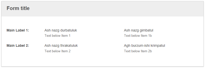

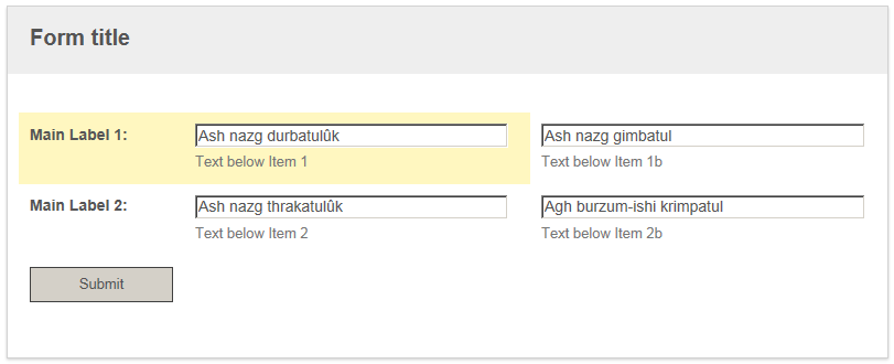

The resulting form looks like 2-FillOutForm.png. Upon submission, the confirmation page in 3-FormSubmission.png preserves the formatting, and when saved to the repository, the PDF in 4-SavedPDF.png also preserves the formatting.
