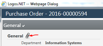

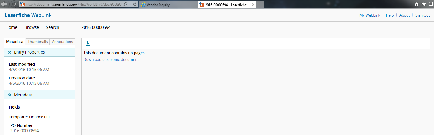

Users go through New World Systems, find a PO, and click on the PO Number. IE pulls up a new window, see PaperclipClick.png attached, where they click on the 'Paperclip' to view the attached PDF. That then pops up another window which shows the "LFWebLinkADF.png" attachment ready to download.
Currently, they click on the download icon and it will download and they can open it. The user asking would like to have the PDF show in that window without having to click on the download button.

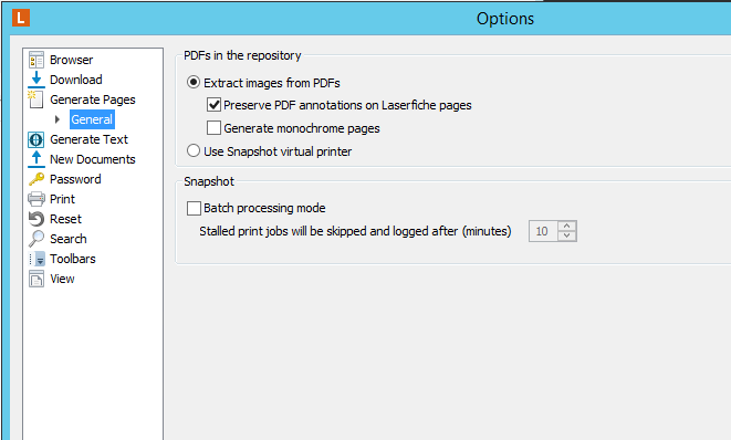

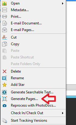

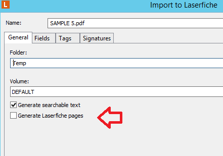

You can generate pages for pdf when they are being imported.
And you can also generate pages for pdf that are in the repository.
