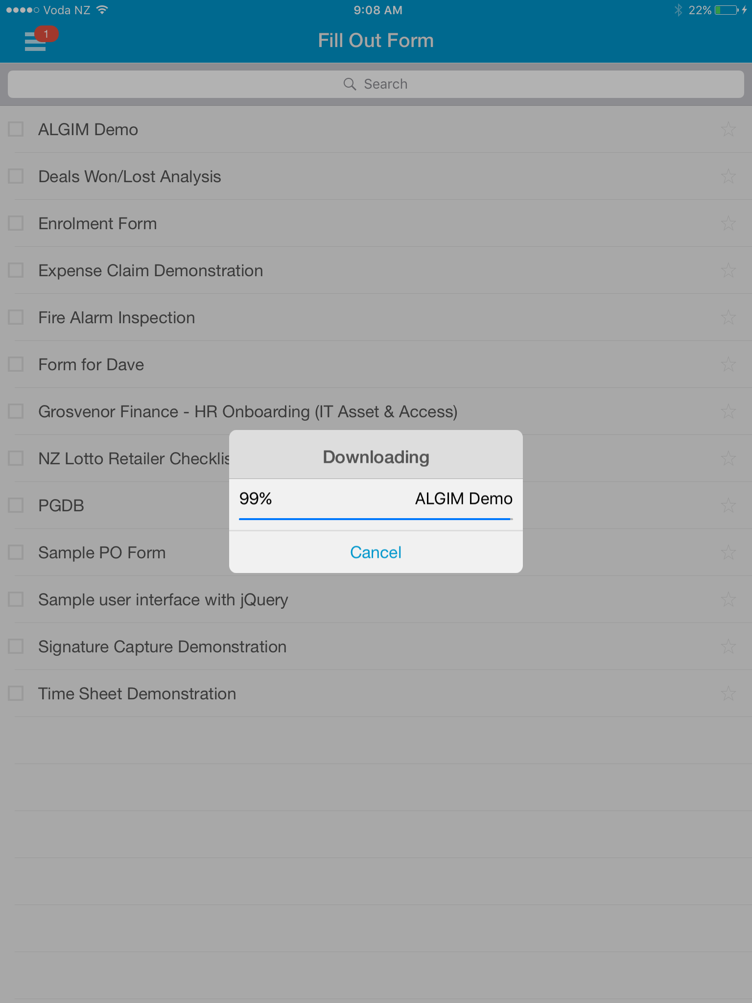

However this issue is not resolved in our Demo environment (same Forms & Mobile release) and same server image.  The offline forms download runs to 99% complete and does not gracefully complete the download.  As shown in attached screen grab.

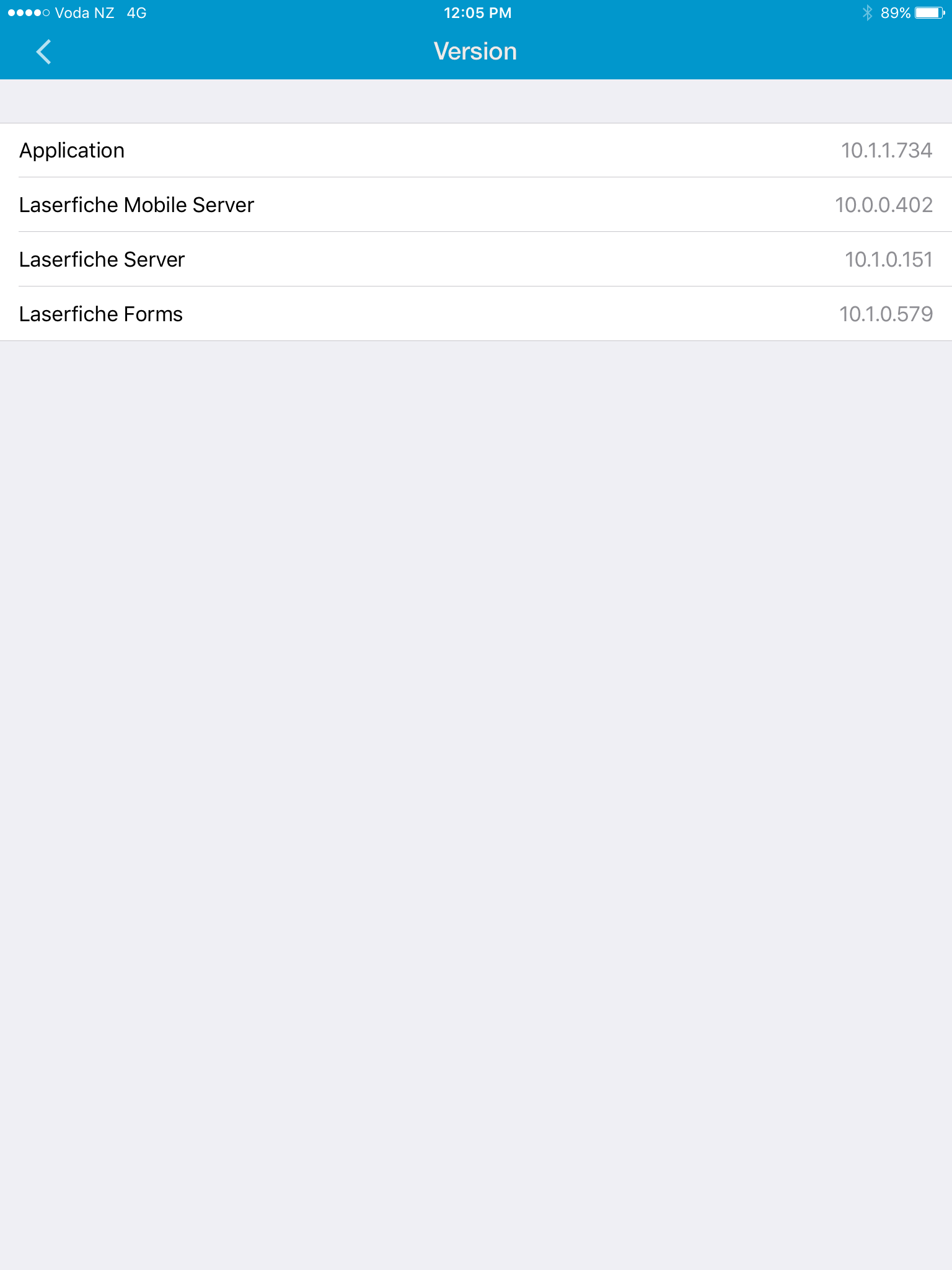

Hello Paul,
Within the App, can you go into settings, and then go into Versions and list all the versions that are placed there? that should include
1) Forms Server
2) Mobile Server
3) App Version
4) Laserfiche Server version.
replied on June 28, 2016
Hi - The versions of the components are listed in the attachment.  I have double checked to ensure the working environment for offline forms and the environment that is not, are at exactly the same release version.
