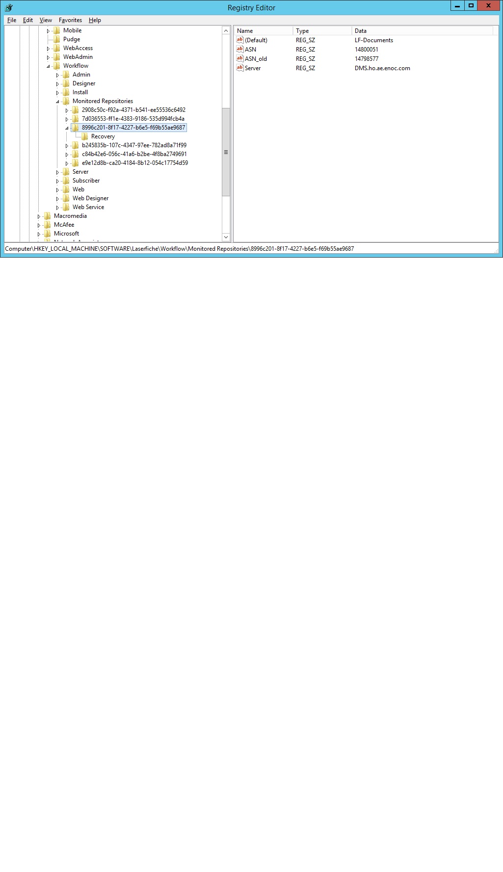

  2. If you configure it beforehand, you can then shut it down and edit the registry to indicate that it only needs to process events going forward: HKEY_Local_Machine\Software\Laserfiche\Workflow\Monitored Repositories\<Repository ID>. Edit the ASN value and set it back to 0. Keep in mind that every time the Subscriber is started, it will monitor the repository for events and write the latest processed activity log ID to the ASN value. So if you do testing of your DR server, you'll have to reset the ASN to 0 after each round of testing.

I could only see one repository with ASN Value in the Registry, other repository does not have ASN key created.
What does the ASN 0 means? Does this mean, Assigning 0 to ASN value makes Subscriber to stop processing which are missed when it was missed?
replied on June 29, 2016
The ASN is the ID of the latest event the Subscriber processed. Setting it to 0 indicates to the Subscriber it's supposed to only process events going forward, not try to catch up where it left off before it was shutdown. The Subscriber service needs to be shutdown before modifying the registry.

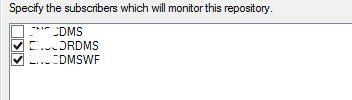

replied on August 17, 2016
Dear Miruna,
The answer was logically accepted and implemented but it did not work that way. When I start the Dr workflow service with Subscriber it automatically took from where it last left.
I've tried renaming the ASN key so that it will do all as fresh. That also failed as it was started again from the place the service was stopped.
Find the attached for your reference. How can we overcome this issue?
