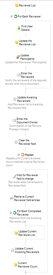

In case anyone is interested, this is how I got the process to work:
The "Update Current Reviewer List" token modifies the "Reviewer List" token, removing the matching value from "Retrieve Current Reviewer field entries".  The subsequent "Update Current Awaiting Reviewers" activity replaces the "Awaiting Reviewers" field value(s) with the contents from the "Reviewer List" token, effectively removing the completed reviewer from the Awaiting Reviewers field.

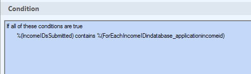

Can you just do a compare of the two tokens?  Do a For Each Value one of the tokens.  Then a routing decision inside where the condition is "is the For Each Value current value contained in the token you are comparing to".  The other side would be not contained.  I am doing something like you but I am comparing a result list from a DB with a multivalue token.  Should be pretty much the same thing.  In mine, if the value is not found in my token I know that value should not be in the DB so I delete it:
I am not sure if you can delete a specific value from a multivalue token.  I seem to remember maybe multi value tokens have index values but not sure of the syntax.  You could just create a new token and populate it based on the routing decision in the For Each loop.
