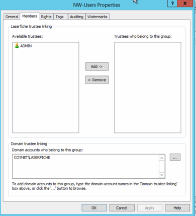

Hi Sandy,
The users will automatically show up under windows accounts as they sign-in, but you don't need to manually add them. You could create the repository groups and then just  indicate which AD users or AD groups you want affiliated with that repository group in the repository group property dialog, you don't have to manually add them first.
Added: This would be in the 'domain trustee linking' section of the members tab.

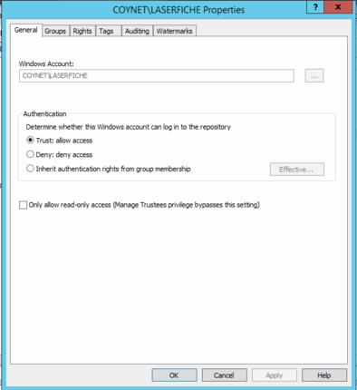

I think I must be missing something.
1. I added the Laserfiche group in Windows Accounts and made them trusted.
2. Then I created a NW-Users group and the members are the Laserfiche AD group.
3. I gave the NW-Users group rights to scan, etc. and also at the folder level.

replied on June 23, 2016

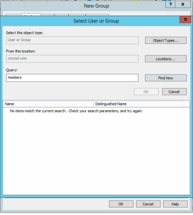

When I try creating a new group and try to add an AD user it's telling me there's no match.
OK I just realized that the name it's looking up is the first name.... so I was able to see the AD users to add them to another group.  But it still doesn't explain the access denied when I try to login.
Trusting the Everyone group I think was the key.  Thanks for your help, everything seems to be working now.
