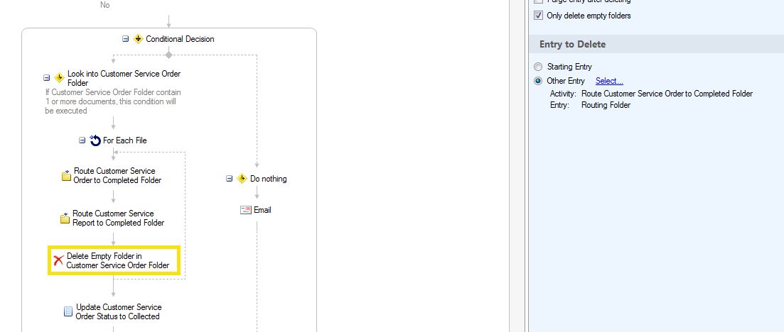

Hi All,
i'm trying to delete empty folders after i did a route entry to folder. i had tried using delete entry
Option : Only delete empty folders
other Entry : Route Customer Service Order to Completed Folder
- Routing Folder
But it don't seem to be working. I think is due to the location where i placed my delete entry. But i not sure where i should placed it.
Thank you.

If I'm reading this correctly, you have one Customer Service Order folder and it's got several orders in it? And you want to delete it after you've moved all orders out? Delete Entry should be after the For Each Entry loop in that case.
If that's not the case, can you describe your folder structure in more detail?

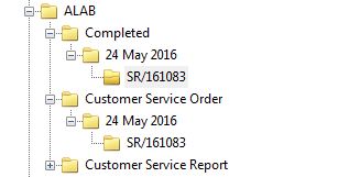

replied on June 21, 2016
Hi,
Thank you for your reply. I got 3 folder. i had attached a screenshot of my folder structure.
1. Completed Folder
2. Customer Service Order Folder
3. Customer Service Report Folder
After routing of the entry, i want to remove the empty folder in Customer Service Order.
I had tried previously putting delete entry after for each, it don seem to be working as well
replied on June 22, 2016
Oh, I see. Yeah, your setup wouldn't work since Customer Service Order is not empty, it has subfolders. So you'd need to delete the subfolders first before you can delete the main folder.
You could use pattern matching on the path to extract the names of the subfolders and then run a For Each Value and delete them.
