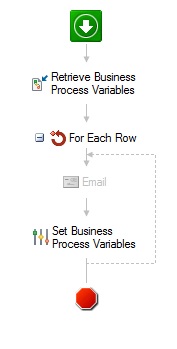

Using the Business Process Variables, i have had success with a single field , but having trouble with only resetting the top line of a table and leaving next rows as per previous form submission.  (FYI :multi value for an item (drop down value ) and description (just text). From researching , I have added for each row
in the workflow but still not working.

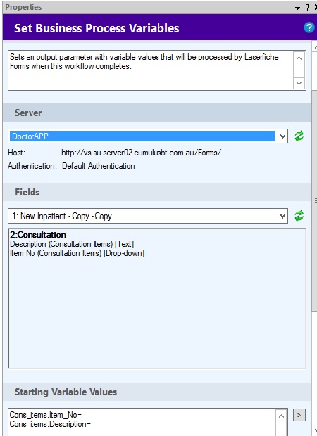

Hello Ming-lun, unfortunately cannot use blank form , it needs to carry over many details which i have working. Just trying to clear the fields with  information that is in the table. I have no issues clearing out the first row of table but no success clearing out next row info.
Hope you can suggest an option thanks.
I put in the email activity to check i was getting each of the multi values of the table. (which worked fine). Here is my BPV setting

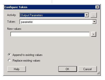

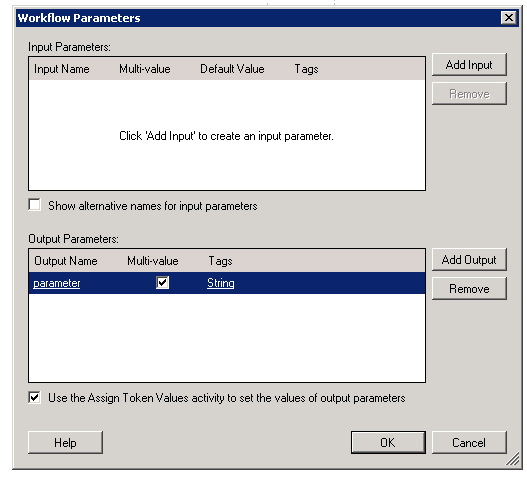

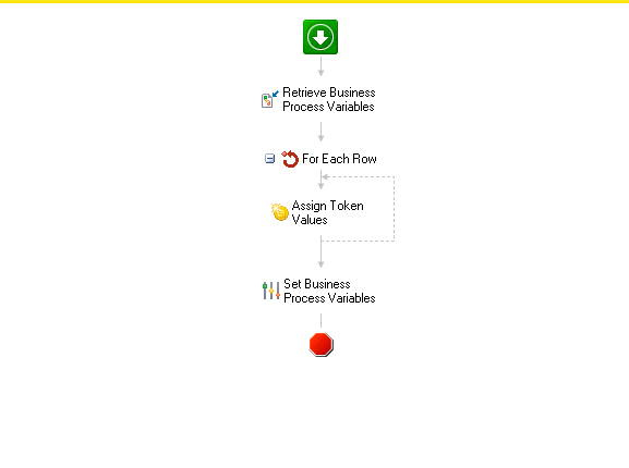

Hi Grant, you can add an output parameter with multi-value checked, then add the assign token values inside For each row as following to assign blank value to the parameter, then set the process variable with the output parameter.

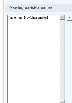

Ok If i use your process as described it only removes the data from the first row, basically the same outcome I have achieved using various methods (including jscript)
If i duplicate the variable in this screen it deletes second row data, however the amount of rows will be variable.

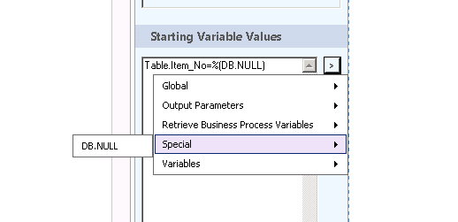

replied on August 10, 2016
Hi Grant,  actually you don't need to use the output parameters as I posted before, there is a special token provided by workflow that allow you to set field values to blank: it is DB.NULL. You can remove the for each row and assign token values activity and set the variable to use %(DB.NULL), this token will remove values in all the rows.
3 0
Hello Xiuhong Xiang , yes that's it, thank you for following through.
