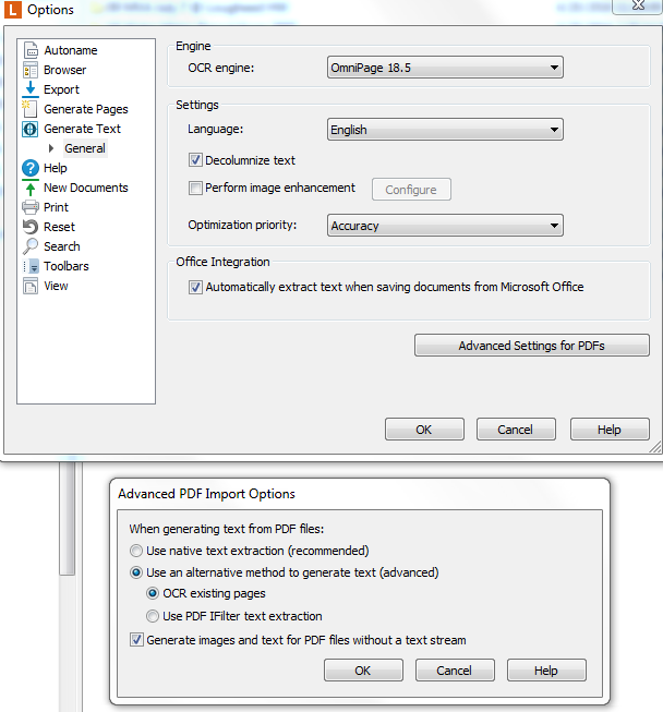

So I rediscovered why I had changed the OCR settings for PDFs: for some reason, using native text extraction doesn't seem to work. I'm assuming this is the case because the pdfs are scanned rather than created natively.
replied on June 20, 2016
These are my settings
Hi Justin,
There is no specific reason for that, no: I'll switch it back to native text extraction and see how that effects the quality.
And you're right, it's a picture of the image when pages are generated. I'm using version 9.2.1., so I suppose this won't be corrected until we get the update?
