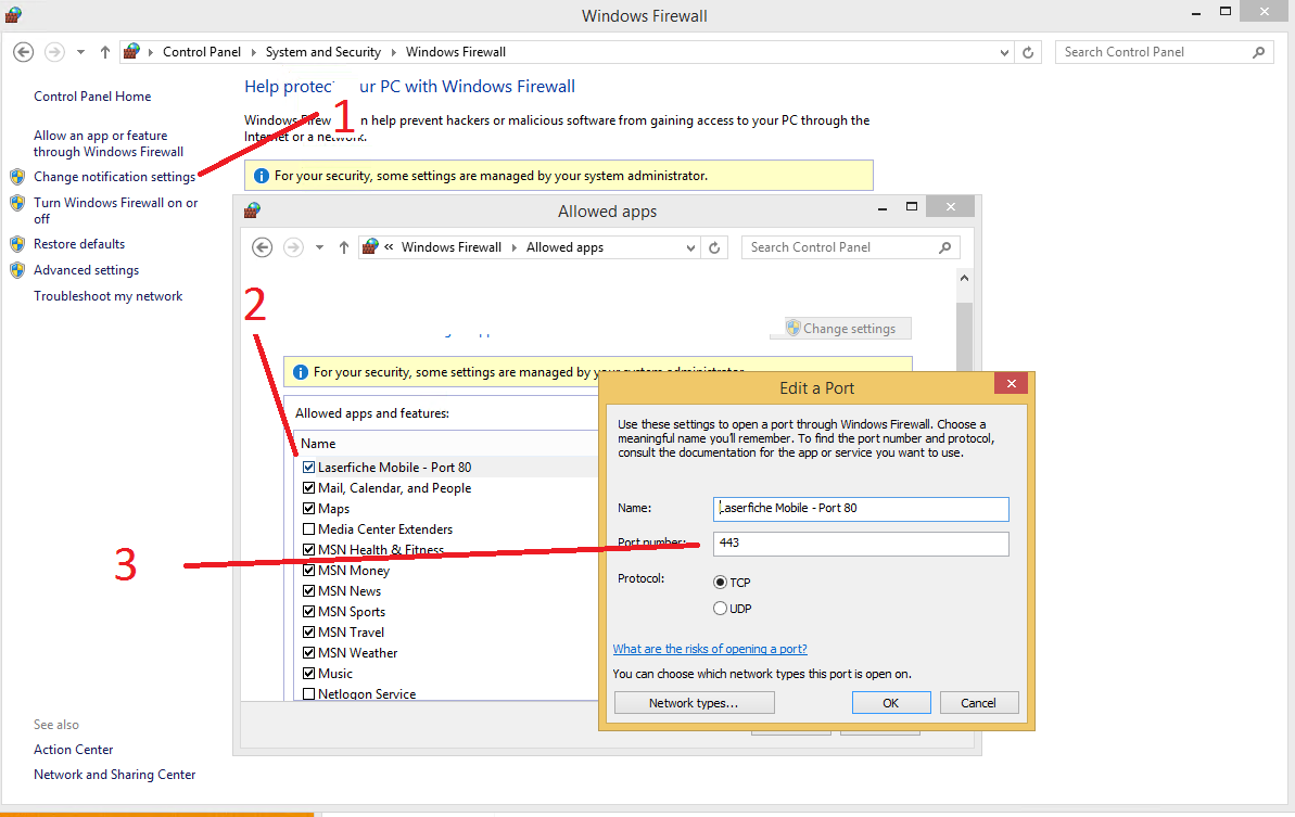

Michael,  Check your firewall settings for access to your Forms server.  Both your Windows firewall settings and corporate firewall settings.  We had similar issue and it was our corporate firewall that was part of the problem.

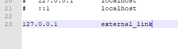

To your Server, find and change "C:\Windows\System32\drivers\etc\hosts".
Add this line  "127.0.0.1          external_link" (without http://  and /Forms)
Save it.

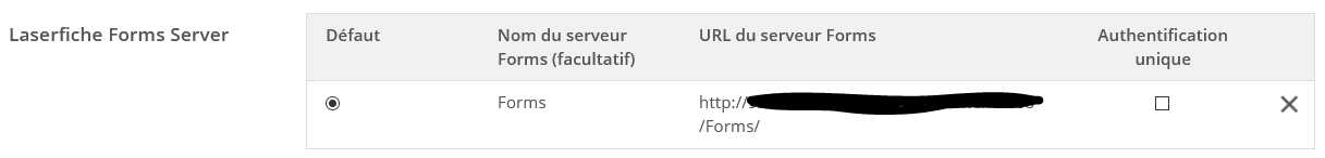

To Mobile Server Configuration / Laserfiche Forms Server, add a new connection with your external URL.
