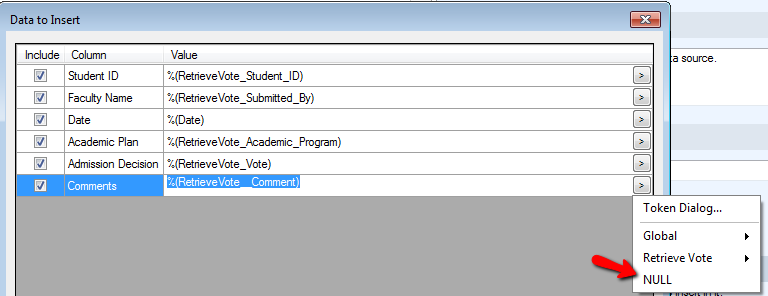

The DB.NULL token is useful if you would like to clear a Laserfiche Forms variable in the middle of a process.
If you would like to set a NULL value using one of the databse activities, you can use this token:
