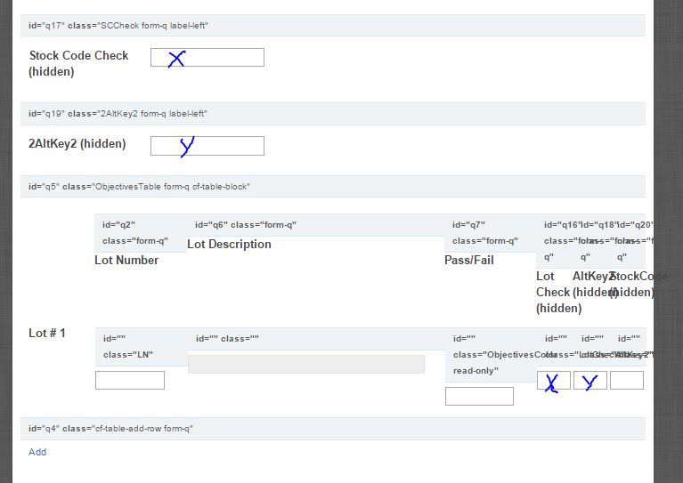

How to check a field in a table against a single line field?
asked on January 27, 2016
I have two columns in a table that I need checked against two respective single line fields. I'm trying to determine if Lot Check (hidden) has the same value as Stock Code Check (hidden). If they do not, I then need it to check AltKey2 (hidden) against 2AltKey2 (hidden). If those also do not match, I would like some sort of error message or warning to pop up letting the user know that these do not match. I have designated the fields that need to match up with an "x" or a "y". If either one match, then nothing needs to happen. My css classes are as follows -
Stock Code Check (hidden): SCCheck
2AltKey2 (hidden): 2AltKey2
Lot Check (hidden): LotCheck
AltKey2 (hidden): AltKey2
How would I go about doing this sort of check?
Thanks!

replied on February 5, 2016
Hi David,
You can use Forms field rules to accomplish that. So show table column 1 when single line equal etc. I have attached a screenshot to give a better idea.
Best,
Kevin
Hi David,
You can use Forms field rules to accomplish that. So show a table column when single line equals what you are looking for. I have attached a screenshot to give a better idea.
However, this does not provide the ability to have an error message or warning pop up if the fields do not match. To do so would require JavaScript.

replied on February 8, 2016
Kevin,
I don't know ahead of time what I want the table columns to equal. It's based on some other inputs from the user. I would also like to keep the columns that check hidden, and only show the necessary information. Any ideas how to use Javascript to accomplish this?
Thanks
replied on February 9, 2016
Kevin,
Is it possible to use the Field Rule to have the input field in the table equal the single line field? I only see that I can have it equal a specific number that I enter, not a variable. Is this possible?
