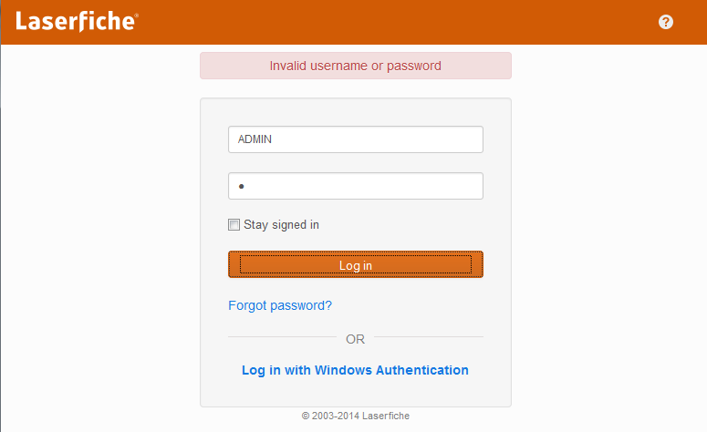

replied on April 24, 2015
The User Authentication tab of my SocialBPMConfig displays the following message:
The site is using a demo license and cannot use Laserfiche Directory Server or LDAP for its list of users. Learn more about adding demo users to the site.
Learn more about adding demo users to the site is a hyperlink to the Laserfiche Web Help below:
https://www.laserfiche.com/support/webhelp/laserfichesocialbpm/9.2/en-us/socialbpm/#CreatingUsersInDemoMode.htm
I have followed the instructions on the above Laserfiche Web Help page and have produced the attached demoUsers.xml (uploaded as demoUsers.txt), the attachment of which does not compromise any security because all of the users relate to the standard Laserfiche demo LaserRepository.
I then attempt to login to my SocialBPM website as user “ADMIN with password “a” (without the quotes) and I received message “Invalid username or password”.
Can someone please tell me what I am doing wrong and what I need to do to successfully login to my SocialBPM website.

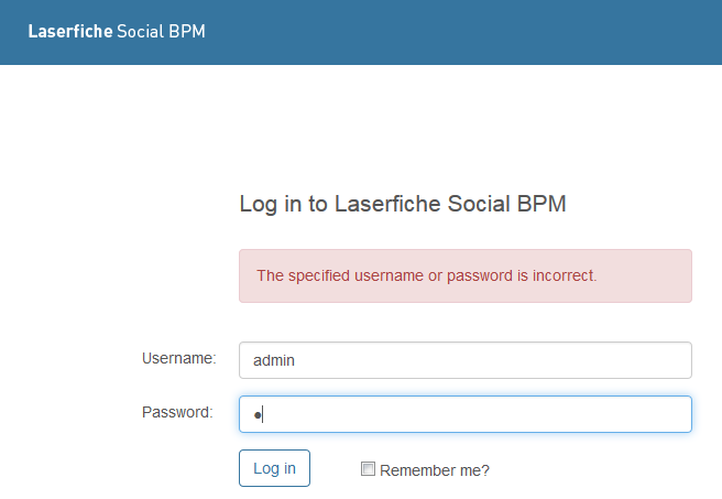

replied on April 27, 2015
John,
Did you previously have Social BPM configured to authenticate against your VAR Demo Rio System? Did you just recently switch the Social BPM license file to one that now has the "Demo" feature such that it should be using the demoUsers.xml file rather than your Rio system and LFDSSTS?
The error message you said you get when trying to log in is "Invalid username or password" but that's the error you'd see when trying to log into LFDSSTS with one of those demo users.
If you were on the actual Social BPM login page, it would look like below:
Note that you'd get a different error message if you were using an invalid username or password.
Please make sure that you are logging in from the Social BPM login page using the demo user (ADMIN/a since the username is case sensitive).
If the issue is that going to the Social BPM site is taking you to the LFDSSTS login page and not the Social BPM login page, then you'll need to modify your web.config file for that because it still has the LFDSSTS information saved in there regardless of Social BPM now using a license file that has the "Demo" feature.
Go into C:\Program Files\Laserfiche\Laserfiche Social BPM\SocialBPM and first make a backup of the web.config file. Next, open the file and make the following changes:
1. Look for
    <authentication mode="None">
    </authentication>
and change that to
    <authentication mode="Forms">
      <forms loginUrl="~/Account/Login" timeout="20160" />
    </authentication>
2. Look for
    <modules runAllManagedModulesForAllRequests="true">
      <remove name="FormsAuthentication" />
      <add name="WSFederationAuthenticationModule" type="Laserfiche.IdentityModel.LFDSWSFederationAuthenticationModule, Laserfiche.IdentityModel, Version=9.2.0.0, Culture=neutral, PublicKeyToken=53e06f26ec0fac4f" preCondition="managedHandler" />
      <add name="SessionAuthenticationModule" type="Laserfiche.IdentityModel.LFDSSessionAuthenticationModule, Laserfiche.IdentityModel, Version=9.2.0.0, Culture=neutral, PublicKeyToken=53e06f26ec0fac4f" preCondition="managedHandler" />
    </modules>
and change that to
    </modules>
 3. Look for
<wsFederation persistentCookiesOnPassiveRedirects="true" passiveRedirectEnabled="true" issuer="https://[server]/lfdssts/" realm="https://[server]/socialbpm/" homeRealm="urn:laserfiche:lfdsdb:[LFDSDB]" reply="https://[server]/socialbpm/" requireHttps="true" />
and change that to
<wsFederation persistentCookiesOnPassiveRedirects="true" passiveRedirectEnabled="true" issuer="" realm="" homeRealm="" reply="" requireHttps="true" />
Now your Social BPM site shouldn't be trying to use LFDSSTS for user authentication.
