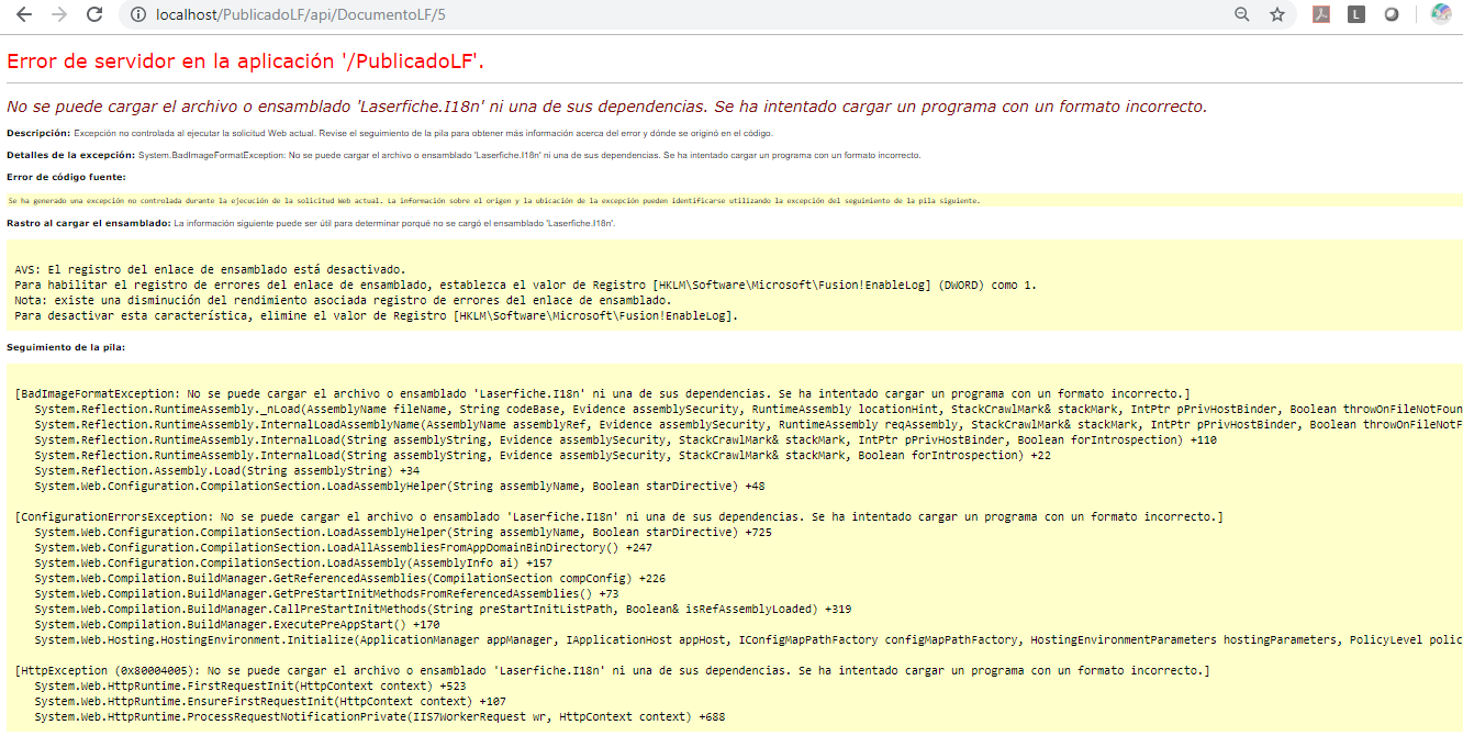

replied on June 5, 2019
I have a web api in ASP.Net that has the reference only to the libraries of Laserfiche.DocumentServices and Laserfiche.RepositoryAccess but when it is published in the IIS webserver, I have the following error,
The server has LF SDK 10.2, LF WebClient installed. This is very strange because it refers to the Laserfiche.I18n.dll library if I am not using it.

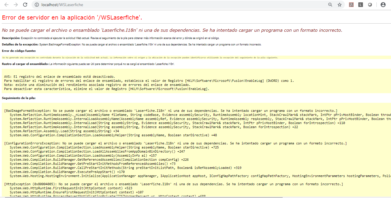

replied on July 9, 2019
I have the following error when using sdk 10 only when I publish it in IIS, I have even created a blank webapi and only referencing the dll and I have the same error. thank you for your support.
