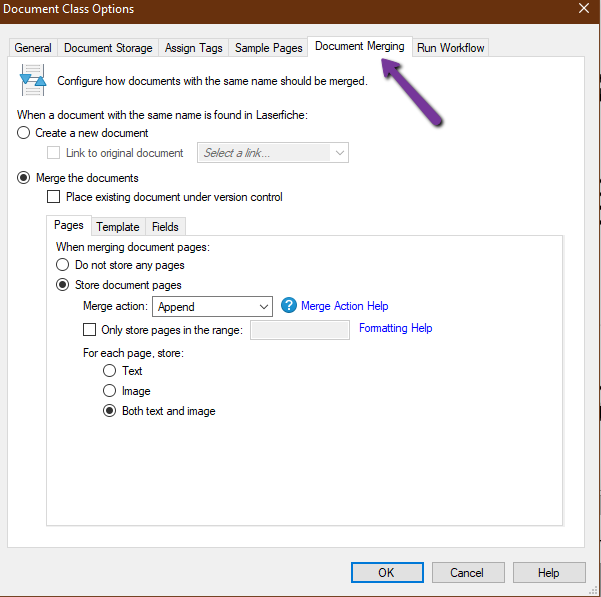

You are welcome - and I do wish there was a better way. In this setting we did not have QF and QF Agent, so Miruna's approach is definitely worth a try.  It looks like QF has the same PDF conversion options, (Scan, Configure Scan Source). For the page replacement options, go to Document Class Options, Document Merging.
That should preserve the metadata, and the PDF will also have tif pages associated with the pdf pages.

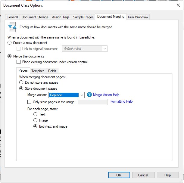

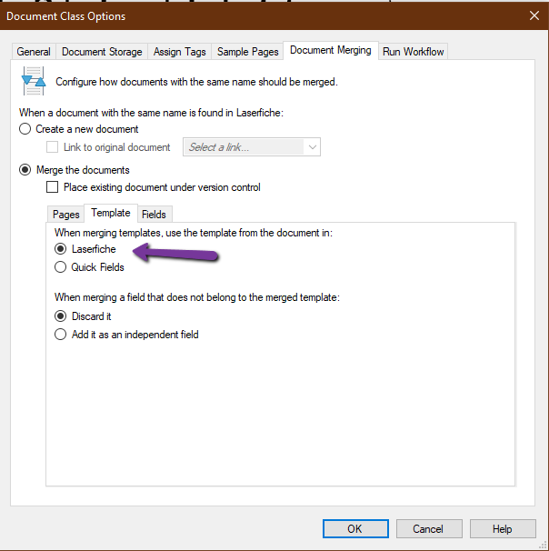

replied on February 9, 2021
In the document class options, there's a section for merging documents if one with a duplicate name is found in LF when Quick Fields sends its copy:
You can specify what you want to send as well as who wins when merging metadata:
