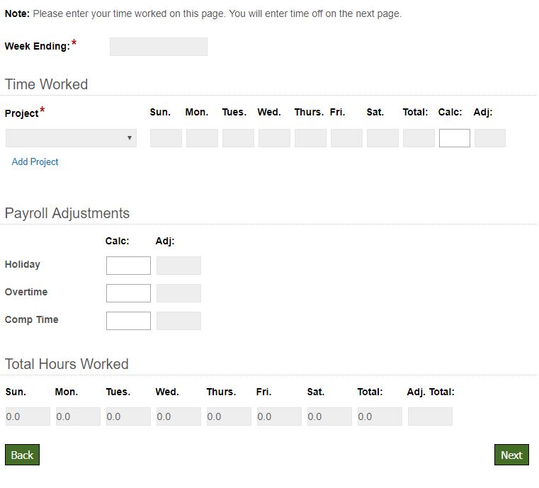

We're in the process of making our entire Time Card process digital via LF Forms. It has been a crazy month to say the least to get this up and running... but we're getting close. Basically, a user submits the form online. It calculates, row by row, their weekly totals. Works great.
Upon submission, it eventually gets to Payroll, who then needs to be able to adjust those rows. We decided the easiest way to implement this would be through two additional columns in a copy Form - one for a calculation (either + or - X), and one for the adjusted total as a result. I imagine through JavaScript, this can be accomplished, but I have no idea how to make that happen.
Can someone assist? What I'd like for Payroll to be able to do is, in the Calc field, somehow distinguish to either add or subtract X value from the Total field, to then equate to the Adjusted Total field. For each row. Attached is the Form example, and my JavaScript thus far, if it helps, which only serves to calculate each row total so far.
replied on September 20, 2017
It sounds like you should be able to do this with Functions (the advanced settings for the field) instead of JavaScript. For example, the Total column for a single row would be like
SUM(INDEX(table.column1,ROW()),INDEX(table.column2,ROW()),INDEX(table.column3,ROW()))
The total for a column would be
SUM(table.column1)
And the "adjusted" total would be
SUM(INDEX(table.totalColumn,ROW()),INDEX(table.calcColumn,ROW()))
Just replace the "table.column" with the appropriate variable from the ">" drop down list in the functions menu.
If they put 1.0 in CALC it will add 1, if they put -1.0 it will subtract 1. The only requirement is that all of the fields be "Number" rather than "Single Line"
Worked like a charm! You're the man, thanks!
