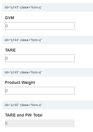

I have a form with some numeric fields to take vehicle weight inputs from end-users.
I'd like to compare a total of the TARE + Product Weight fields and if greater than the GVM field, then display some sort of validation error (similar to when a required field is left empty or display some Custom HTML ), to end-users.
TARE + Product Weight should not exceed the GVM.
I've configured the TARE and PW Total field to sum the TARE and Product Weight fields using the "Advanced > Calculation".

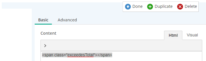

3. add a Custom HTML field at the bottom of the form. Under the HTML tab type this in:
<span class="exceedesTotal"></span>
