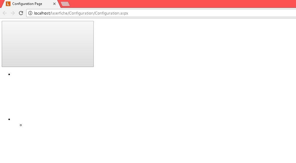

I upgraded my Laserfiche from 10.1.2 to 10.2.1.
Since upgrading web access I am unable to configure the web client at all.
I am just getting a blank website.
I did uninstall & reinstall the web client & also ran a repair on the server.
I have also tried Internet Explorer, Mozilla & Chrome with default settings.
Has anybody experienced this issue before?
Web Access.JPG (27.54 KB)

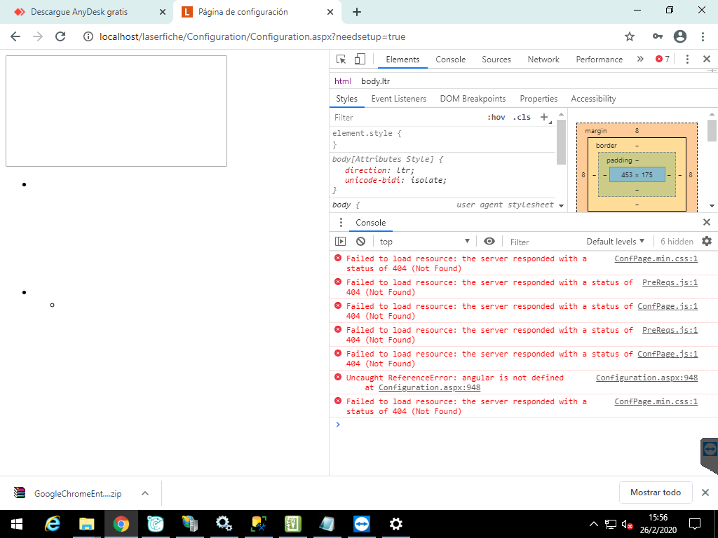

replied on February 26, 2020
I have the same issue someone finds the solutions?
Ryan's reply above is still the first trouble-shooting step. Do you see errors in the browser console?
yes this
I would start by confirming that those files exist on disk. The Network tab will give you more details on where exactly under the install path they should be. I assume that they are there, which means somehow IIS isn't returning them. There might be some information in the Event Log on the server machine. And you might want to double-check that you have the relevant components of the IIS feature installed. After that, you might want to open a support case.
replied on June 21, 2017
Hi Ryan.
I am receiving 404 not found errors. But no 500 errors.
The event log only has the following information.
2017/06/21 16:03:06: Warming up application
2017/06/21 16:03:06: Requesting http://localhost:80/Laserfiche8
2017/06/21 16:03:17: Response: 200 OK
2017/06/21 16:03:17: Requesting http://localhost:80/Laserfiche
2017/06/21 16:03:21: Response: 200 OK
