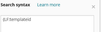

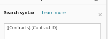

So not sure why, but no matter what search we build with the URL syntax from the help file we cannot seem to get it to work.
We have the initial string of:
http://servername/laserfiche/browse.aspx?db=repositoryname#/?
This works and takes us to our repository.  Then we add search= to the end of that and put in our syntax.  We have tried a simple template name, doc name, field value, and may other things but nothing seems to work.
For example we tried search={LF:templateid=4} and we get a syntax error
or search={[Contracts]:[Contract ID]="12"&{LF:Name="*",Type="F"}
Not sure what seems to be the issue.  Any ideas?
