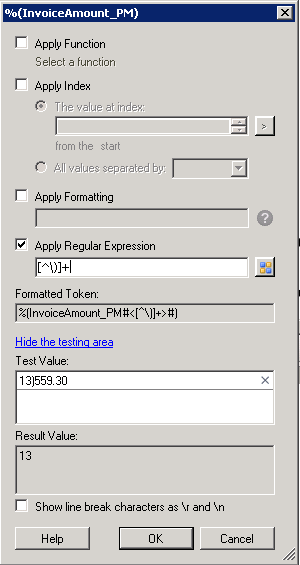

I'm trying to use the [^\)]+ in the token editor but it will only then match the first digits and not the rest.
How do I get it to just exclude the ) and keep the rest? Thanks.

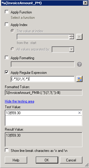

Hi Lucas,
Would the following expression work for your needs? It will grab everything before a ")" or ",", and everything after.
You could make it explicit to only accept digits like this:

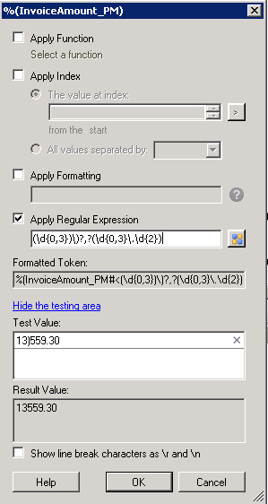

(\d{0,3})\)?,?(\d{0,3}\.\d{2})
replied on December 28, 2016
Thanks Tom
The first pattern worked in regex101.com but not in the test area of the token editor but the second pattern worked great. Thanks. I was researching and I got focused on the ^ function to try to exclude the character.
