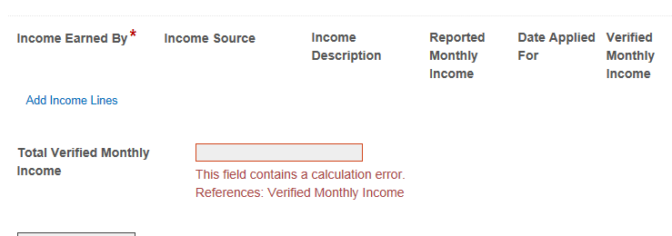

We have a form that is a table where we have the Income lines adding off the total of the verified monthly income.  We are using the normal SUM formula on the field and it is working fine:
However, the users should be able to delete the rows.  Essentially this is income information for a benefit application and if the user wishes to edit things they can.  They also should be able to delete all the rows and submit the empty form (thus deleting the income lines through workflow).
The delete and everything works great, however because of the calculation field I cannot delete all the rows and submit (the calculation field was a recent addition).  So if I remove both the rows I get:
How can I get around this and let the Form get submitted.  I also cannot put 0 in this field because 0 verified means 0 where nothing means the verification has not happened yet.
Also note that the field works fine when you have no lines to start with.  If you get to the form with no pre-existing Income lines then you can add lines and everything works.  It seems to be when you get to the form and the table populates via a lookup that I get the error.
Thanks,
Chris
replied on August 3, 2016
SCR 147132 has been filed for this, targeted for the next release of Forms.
replied on August 4, 2016
Thank you for the update James, appreciate it.
replied on January 12, 2017
This issue has been fixed with Forms 10.2

Hi Chris,
What about a hide rule for the Total field if you don't have a verified amount, would that work?
replied on July 29, 2016
I'll have to give it a try and see if thats a workaround.  Users simply want to always see the field (just their preference).
